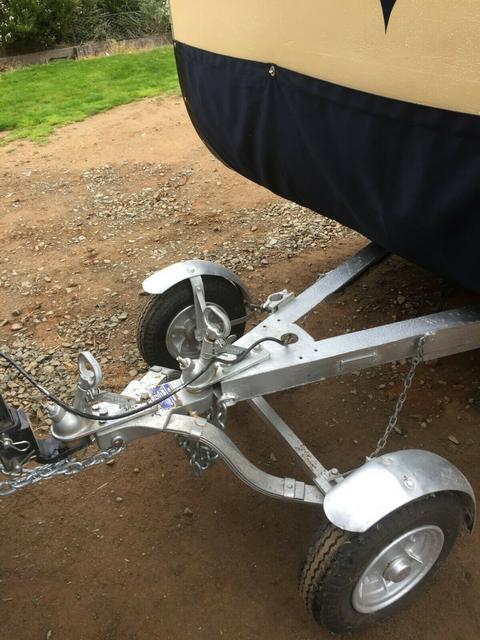

Post by cobber on Sept 23, 2016 13:45:24 GMT 10
Thank you everybody for letting us know what you reckon about these Hutchinson Dolly Wheels, I think we are all on the same page, they serve no useful purpose on vans that have a tow ball weight of less than say 90kg. Tow ball weights above that they start becoming more useful as the tow ball weight increases up to a certain point when it becomes necessary to fit the load leveller bars that were supplied with the later model dolly. To read the patent application pertaining to this model dolly CLICK HERE Anyway, my Newcastle van weighs 120kg on the tow coupling so I thought it would be more inline with what the Hutchinson Dolly was designed to accommodate. When it was hooked up to dolly the weight on the dolly front coupling is 50kg so that is quite a reduction of load placed on the FJs tow bar (70kg), that allows it to stay pretty level and ride fairly smoothly. The chains to prevent jackknifing are clearly visible in this photo Thing is, the weight of the van itself, still makes the poor old FJ puff, especially on a long uphill drag, so I will still use the Holden Captiva to tow the Newcastle van most times, and guess what ? The Captiva has automatic self levelling rear suspension. So for me this dolly just represents an example of the historic evolution of the way problems were resolved in vintage caravan days, I reckon. Cobber.
