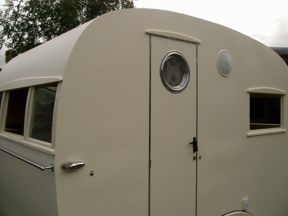

This picture of my van is of the front corner. It shows the rail at the front for drying towels. The side clearance light has a coloured globe in it. The cover is of a Volkswagon Beetle pre 70 and has a mount underneath to hold the globe. It was going to cost to much to do up the old ones so this shape is close enough. The port in the door has been restored and with its original piece of glass with the Castle logo on it looks a treat. Better get back to painting

Congratulations on an inspiring effort Retro1...you should be very proud of what you have created there! I WAS considering a modern van (shhh...don't tell anyone ) until I began following your progress....now I am truely and permenantly converted!!!!! Absolutely love the way you've done it....and am on the edge of my seat each time I check in on your progress....the Castle porthole glass being retained is the icing on the cake....how many of those little beauties would still be around.... .. I'm sure I would not be alone in saying that the suspense is building as we wait to see what little tricks you come up with for the interior!! Not that we want to put you and Mrs Retro1 under any pressure...!!! ;D Keep up the great work, Marc, Jane Amanda and Zoe (Jazhow2)

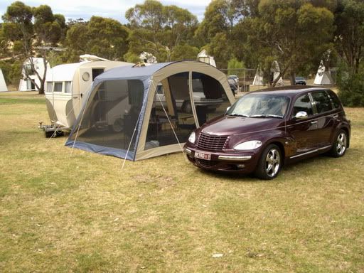

This is a shot of our site at Wirrina caravan park SA. As you all know the " Castle " is fairly small, so this is a where we spent most of our time out-side the van. As we don't have an annex yet we found the perfect outdoor companion for the van ( no fly's on me hey ). Got it from K-mart and it was easy to assemble and very practible.
