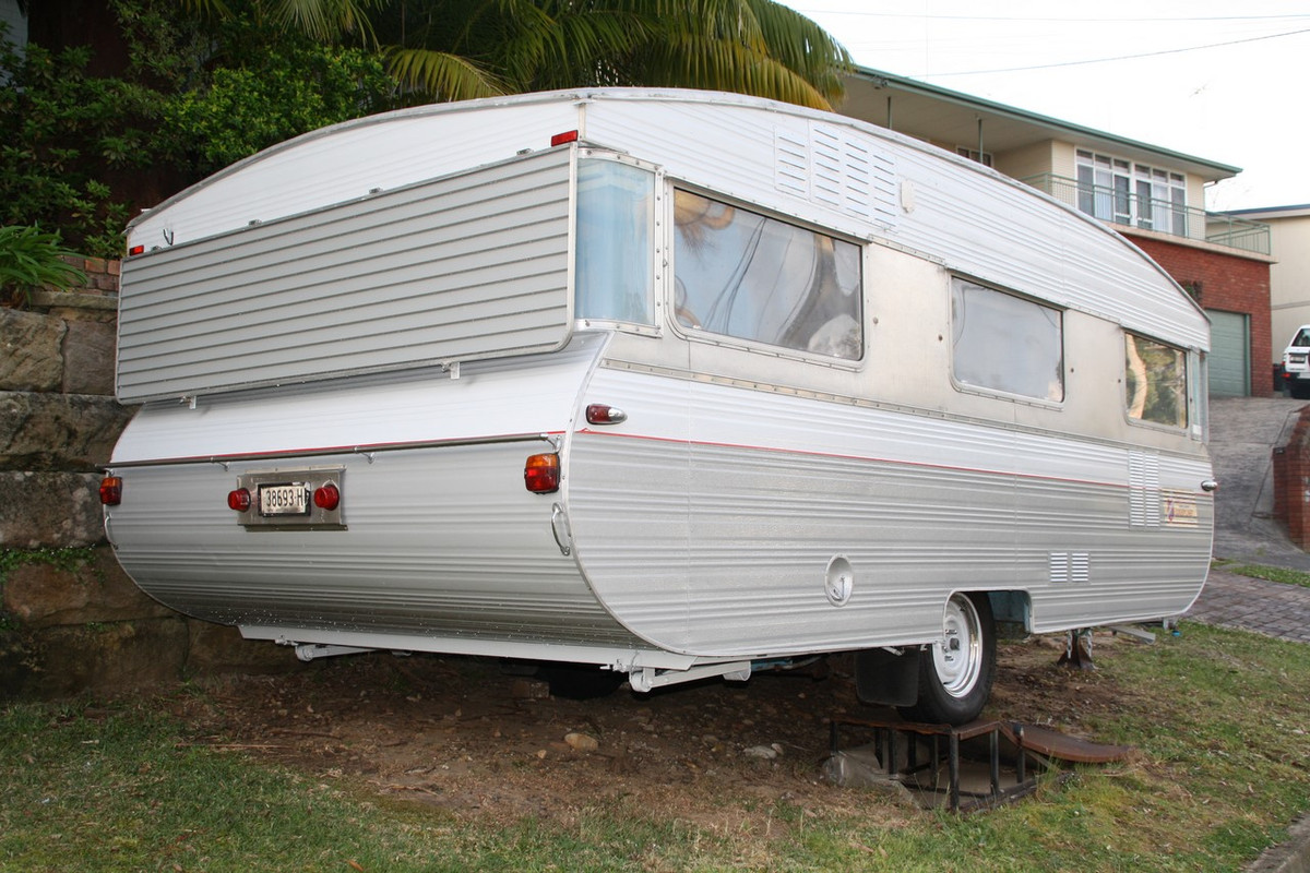

Post by Geoff & Jude on Jan 29, 2021 11:12:37 GMT 10
I’m trying to polish the aluminum cladding on the outside. hi when we first had the ritz, the centre panels were painted. we removed the paint with stripper then "polished" the aluminiun with soapy steel wool. that was 15 years ago and this is how it still looks without ever being redone or ever actually using any polish. don't use steel wool though unless it's soapy, otherwise it will leave lots of streak marks. geoff 'n jude
