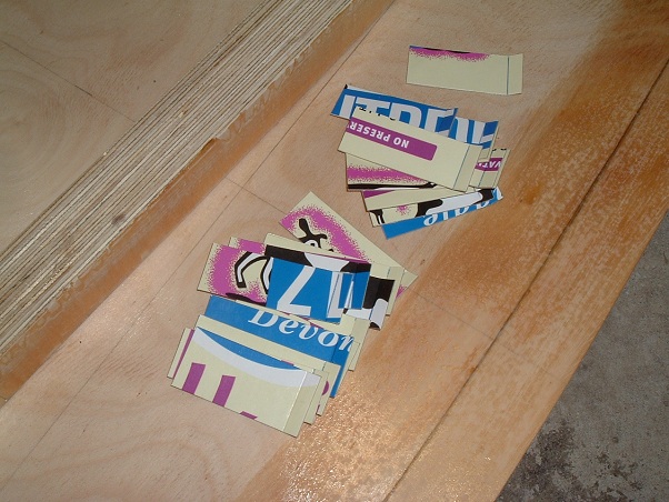

Progress has slowed considerably on the project, due to a medical situation with my partner requiring daily attention (infected foot). Bit by bit, I've managed to essentially complete one wall, which involved glueing the laminated block around the perimeter of the wall. In preparation for the big glueing job, I first cut some spacers out of a thick cardboard milk carton... After the glue was applied to the joint, the laminated block was carefully placed into position, and the spacers were inserted on one side and clamps applied over the spacers. This meant that the pressure was applied to the spacers, which stopped the glue being totally squeezed out of the joint. Once the glue had "cured" sufficiently, the spacers were pulled back out... The next step was to apply a strengthening "fillet" around the inside of the laminated block. There is a powder filler available in the Bote-Cote range, which is added to the resin mix to thicken the mix up... The thickened mix is used to make the fillet. The mix is pasted into position roughly, and then shaped to give a curved appearance. Using a $2 coin to give me the right radius, I cut and shaped the handle of a plastic scraper to use for shaping the fillet... And here is the wall completed and ready for fitting to the chassis... Now for the other wall, so I'll see you in another month... cheers, Al.
