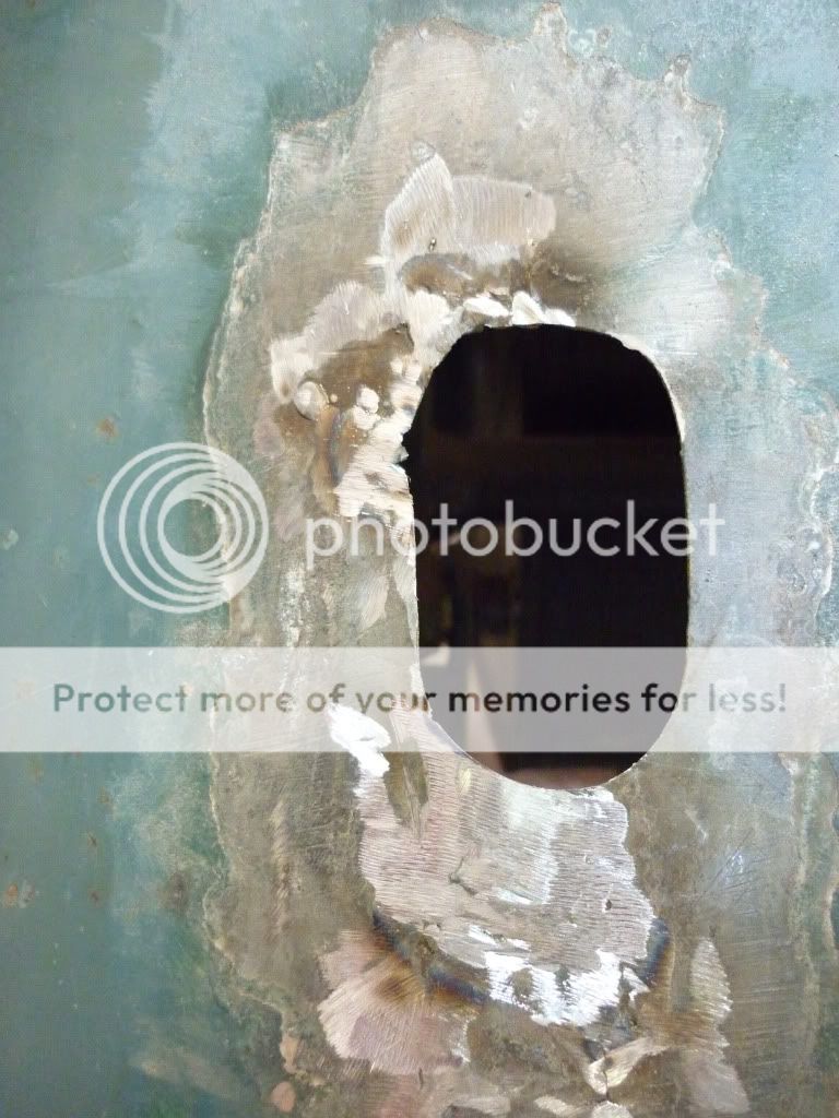

There were 2 things that amazed me today... 1. It is 2012 already - not sure what happened to 2011, but it has GONE!! 2. It was last February when I made an update to this post. Again not sure what happened there, but like the first lesson GONE!! OK 2011 did not see a lot of progress on the Morris, there were driveways to lay, back yards to landscape, our twins turned 18 (epic party - which I am told means it was good) and the youngest turned 16. Several weeks working in Singapore and Bangkok (no vintage vans in either place) Still 2012 is the "Year of the Car", on good authority from my wife so I have started out well. Firstly last September (my birthday) my wonderful wife paid for a new toy for me. We settled on a MIG after lots of research, and gotta love e-bay picked up this machine for a bargain (it has done very little work). Anyway so I had a couple of days after Christmas and this week end as well, so it was time to get stuck in. First job was to repair where a previous owner had hacked away at the bumper holes in the rear of the car to fit a tow bar. (Don't worry guys - I will fit a tow bar, just with less butchering!!) First up fold back the steel that had been bent away.... Next, weld it up and grind off the excess.... Then make a little section to replace the missing bit. Actually this was cut from the rear panel of a washing machine. Weld that in.... So now the back of the car looks much better.... OK so I got some confidence up and so let's move on to bigger bits!! Here is inside the rear guard before... Here is inside the rear guard with the new piece fitted (still needs some additional welding and filling, but I think you get the idea! I have also been working on the timber frame - some progress with the rear quarter window sills. It is going to take some time I think to get the frame all sorted, but will continue cutting out rusty bit and replacing with washing machine back panel! So there is the update for today - hopefully the updates will be a bit more regular this year!!

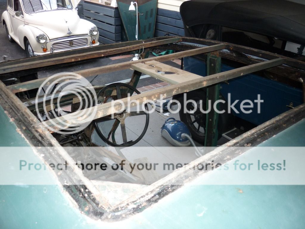

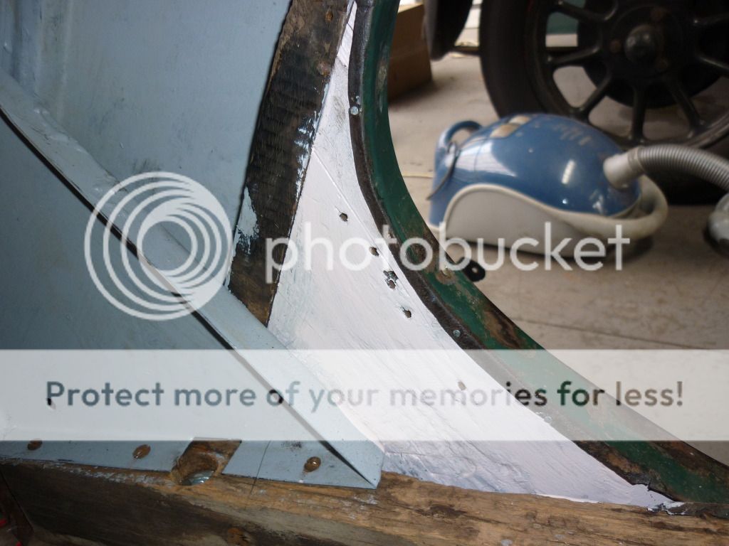

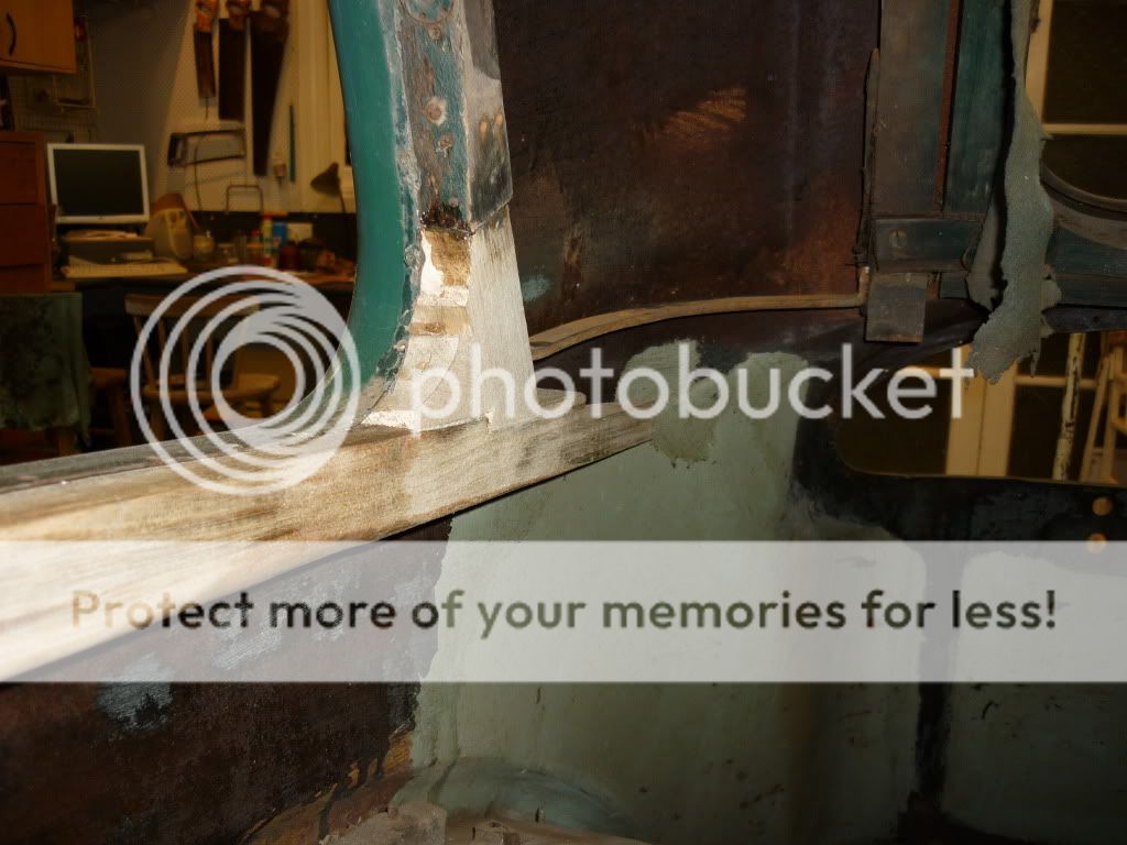

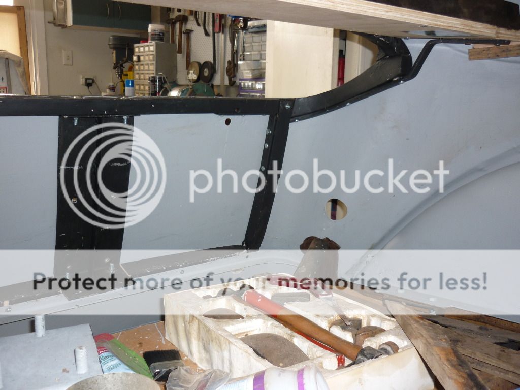

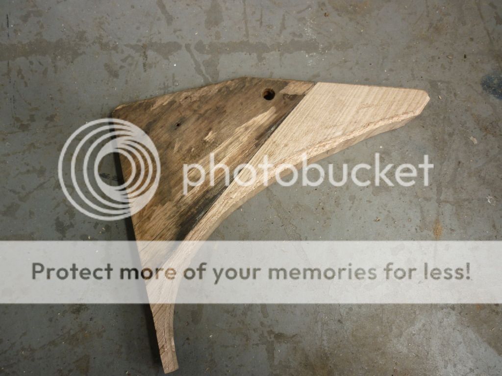

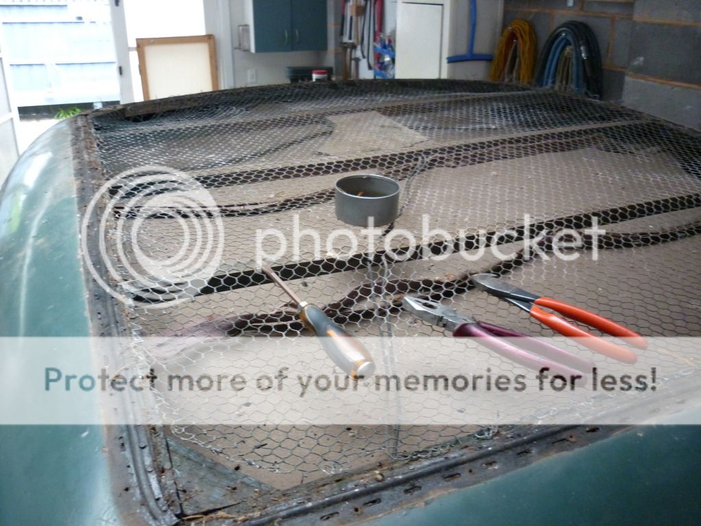

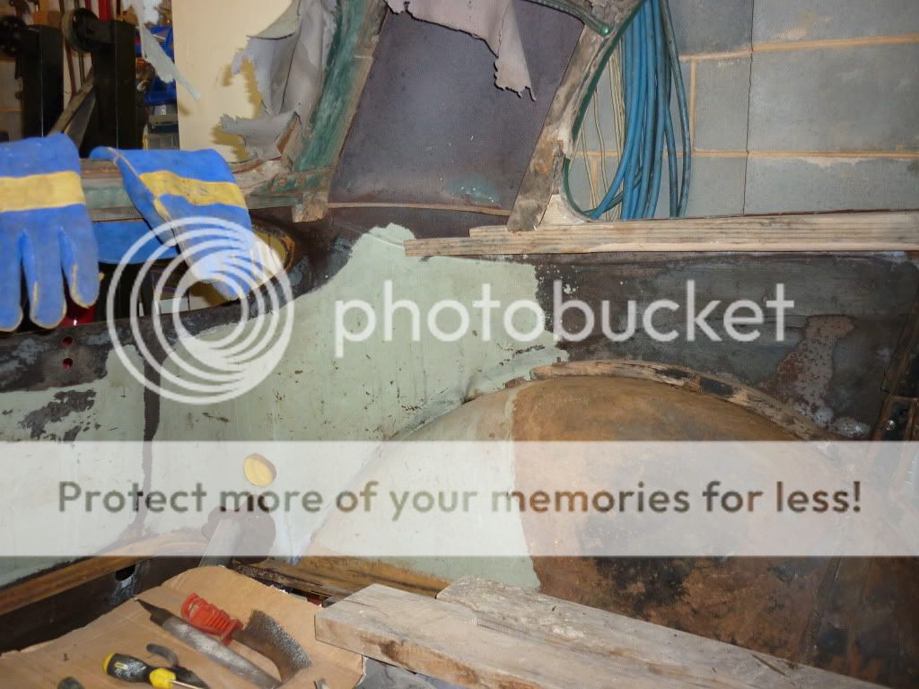

Greetings again fellow Vintage Vaners (and tow car lovers). I have realised that is is about 10 months since I last updated the resto of Amy-Lee. Actually is is about 10 months since I did any real work on her. Still the Morris Minor is done (youngest daughter), the Nats are over, and I think all other cars are now working so I can get back into the Twenty Five. So here is the update. I have restored, replaced and refitted all of the timber work in the rear of the car. Thankfully I had posted photos on the forum before I pulled it all apart. Used those to help me put it back together. ;D ;D ;D There was also a little more timber work to do. Adding some new to the old. I really am impressed with the 2 part epoxy resin - the joint is stronger than the hardwood (which at 75 years old is VERY hard) And then the part painted and fitted. (Yes I used steel slot head screws) So now it is time to start getting ready to paint. All of the welding and timber is done, so out comes the tonneau roof panel. Remove the aluminum strip and piece of tonneau. Then 2 layers of hessian and cotton wadding. Then the chicken wire! And finally the head lining Then the remainder of the interior trims. Must have pulled out 500 - 600 little tacks!! So here is what I have now. Hopefully the progress continues!! Dave

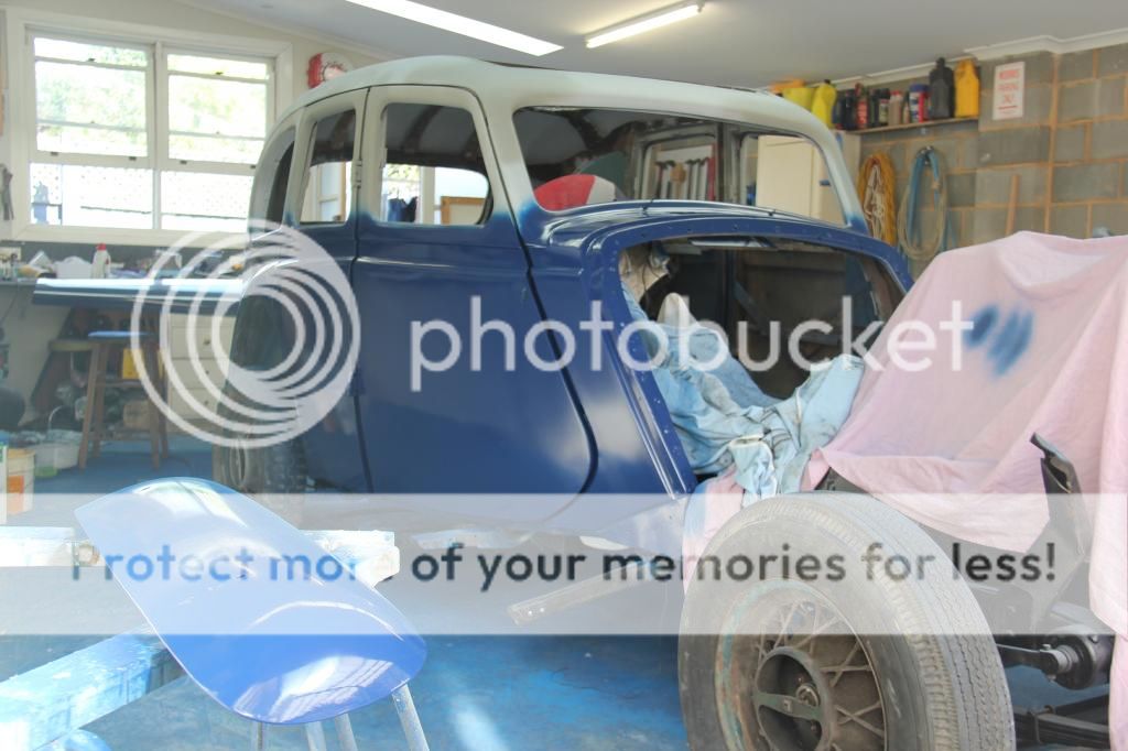

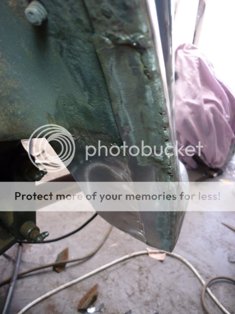

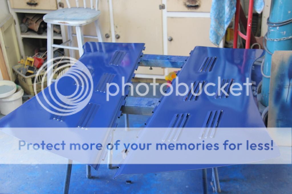

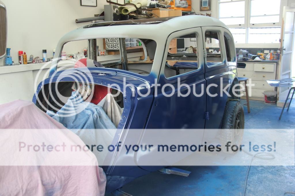

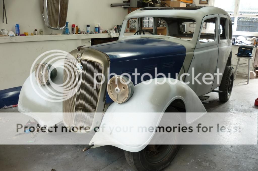

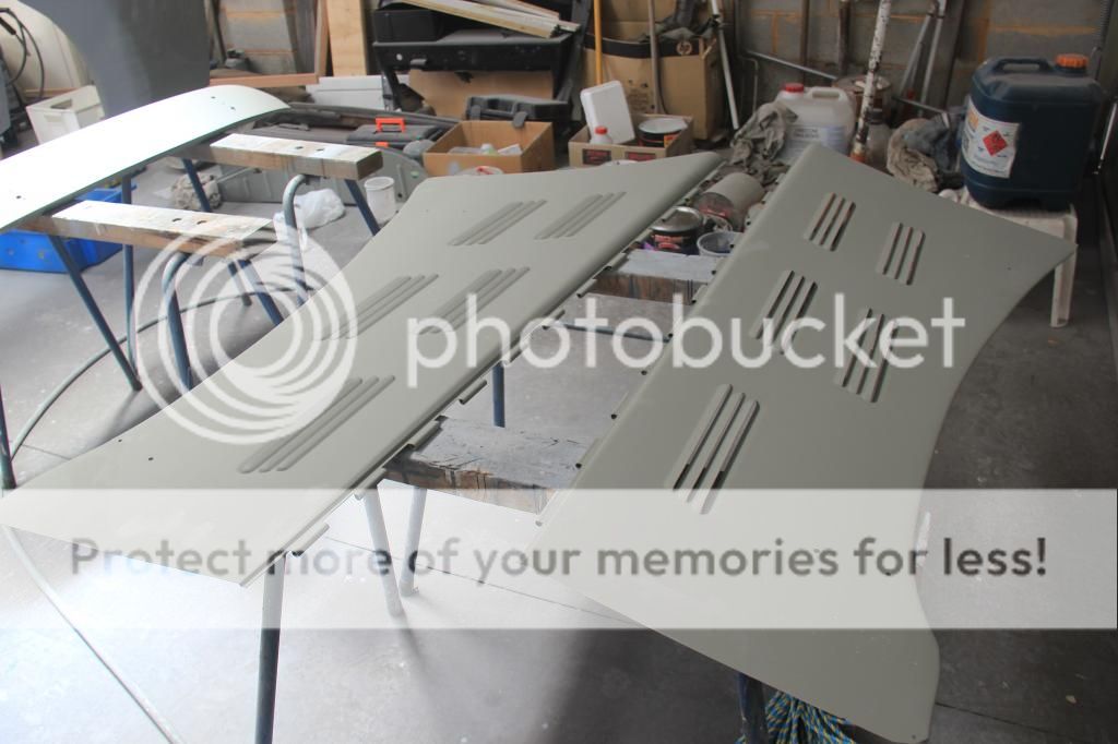

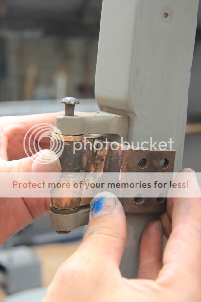

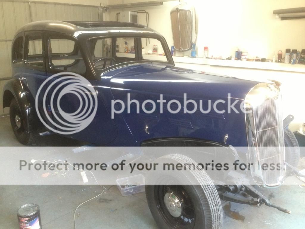

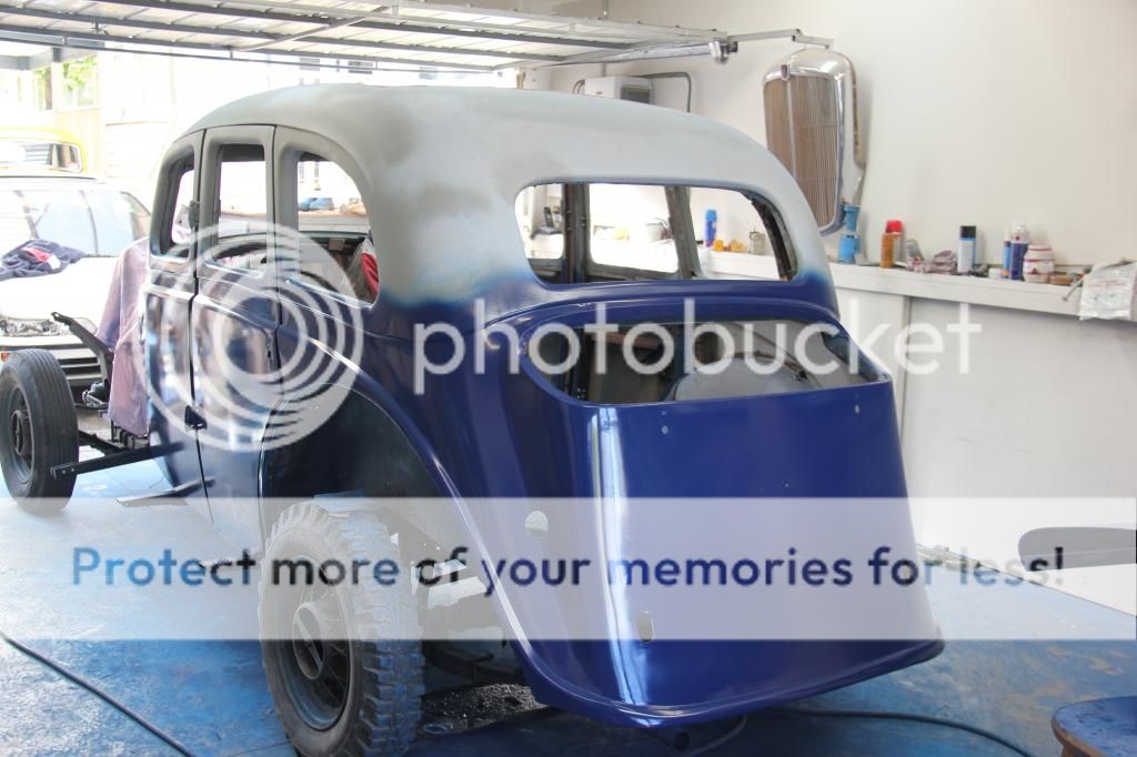

OK, so it has been a while since I even logged in to the forum, what with work, family and doing an MBA there is little time for anything else, but I really do owe this community an update on the progress with Amy-Lee.....so here goes: After a whole lot of paint stripper, some repairs to the lead filler, panel beating and elbow grease - it was time to start painting. (sorry for the lack of progress photos of this part) But after putting the etch primer on with the doors hanging (and swinging) I decided I should mount the doors on the car for paining. Glad I did, as the driver's door no longer fitted. I must have bent the body when I took it off and stored it. VERY SAD...... Also had a couple of broken door hinges to contend with..... So while I took some time to think about what to do - I was keen to try some colour on the car. I spoke to Leigh (Sportsman 1) from the forum and he gave me some great advice about how to align bodies on the old cars, so we re-assembled all we could to work out the problem.... And after a full day of mucking around, we got is pretty good. Actually with out a word of a lie, fitting the doors back tot he car has been the hardest part of the entire project!! They are not perfect still, but I have checked the original photos and discussed the topic with many people, and I think they were never a perfect fit from new!! Anyway, back to the progress. It was time to paint for real now!! I am pretty happy with the blue by this stage, and so we moved on to paining the black! There is a photo somewhere of the black going on, but its whereabouts eludes me currently... Anyway here is what she is looking like with a black roof: The I started to put her back together.... I have also had some chrome plating renewed - golly that is expensive. Will have to save up to get the rest done!! Still it does look nice..... ;D ;D And here is where we are up to now. Includes the wheels done, new tyres, and some brand new hubcaps I found on the Internet from the UK!! So there you have it - some progress. Next I am making anew marine ply floor, and starting on the interior. I will try to make sure I update the post more regularly. Dave

Post by humpyboy on Oct 28, 2013 13:17:35 GMT 10
Nice one Dave, always a good feeling when the colour goes back on, means your just that bit closer to the end.
