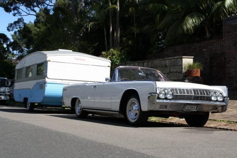

hi all had the continental up against the "ritz" today to measure up the new gooseneck for the towbar. (the first gooseneck i made had the ball too close to the bumper and i couldn't get the coupling to drop on completely). when i lowered the "ritz" onto the ball but not "clicking it in", the rear of the conti went down 5mm from the unloaded position, so the original spring uplifts seem to be doing a pretty good job.   and the whole rig is only 11.5 meters long, that's 37 feet 9 inches in the old money, so it won't take up much room at all. now all i've got to do is repaint the van to finish off the set. geoff 'n jude
