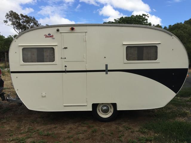

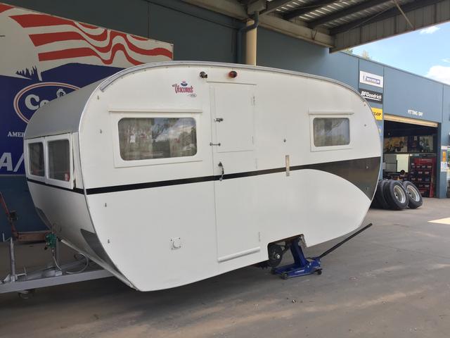

Post by shesgotthelook on Dec 17, 2020 13:26:11 GMT 10
Not sure if this is the same problem or not, but it was very difficult to change the tyres on my 1950's Viscount. The tyre shop had to jack it very high to do so & I'm not sure we could change a tyre if we got a flat on the road.
