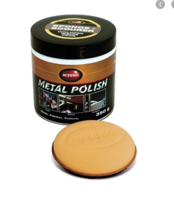

Post by shesgotthelook on Oct 27, 2020 12:45:34 GMT 10
Which autosol? I use the one in a small,black,round tub. The residue sounds like the grime & oxidisation coming out of your metal. We just finished polishing a heap of window frames & they are sparkling like new, the mess on the cloths & workbench is putrid though.
Post by biddyviscount75 on Oct 27, 2020 13:02:09 GMT 10
Yes that’s the one. So maybe I jus5 need more product or to keep polishing...
