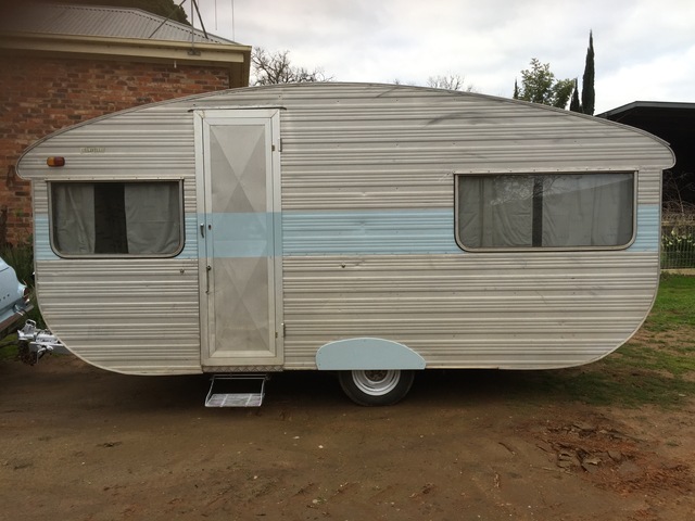

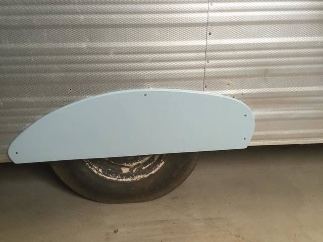

Post by shesgotthelook on May 21, 2020 21:48:02 GMT 10
Made these a few years ago.

Post by rob on May 22, 2020 7:57:39 GMT 10
Thanks again for the pictures!

Post by rob on May 22, 2020 8:02:09 GMT 10
Post by Koala on May 24, 2020 17:59:11 GMT 10
Hughdeany is correct, the original spats were very weak and not many have survived. I made some from marine ply as per the photo for our 69 Franklin. Best to try to make the correct shape if you can. Koala
