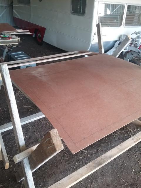

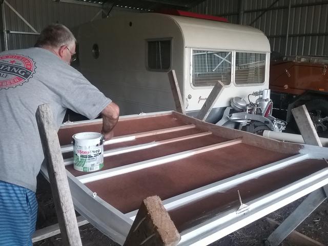

   Have the new timbers in place and started to put the new masonite on and one Jennison in shed. All the main frame was in good condition and just needed sanding have made a temporary frame to put roof on to save back from bending down too long cheers chris

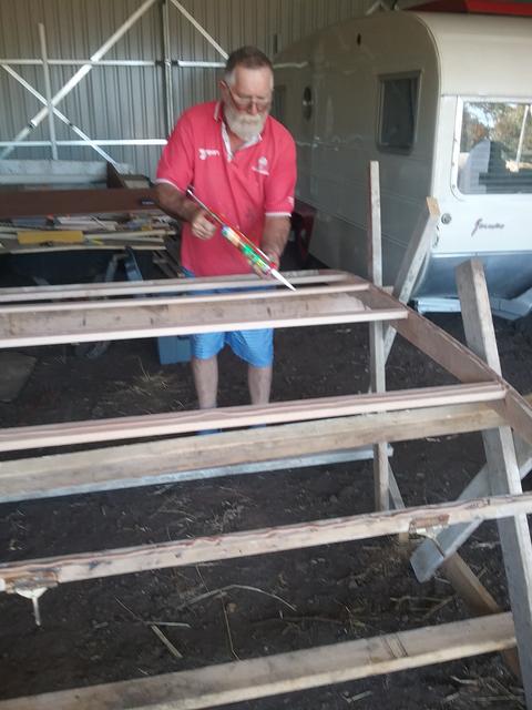

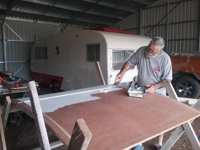

 Bending and nailing the side supports for the masonite was not fun🤔    Started to get paint on them looking good but do I go with the jennison trademark and paint The hatch red on the out side to match the stripe on the side of the van cheers chris

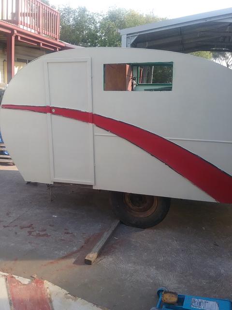

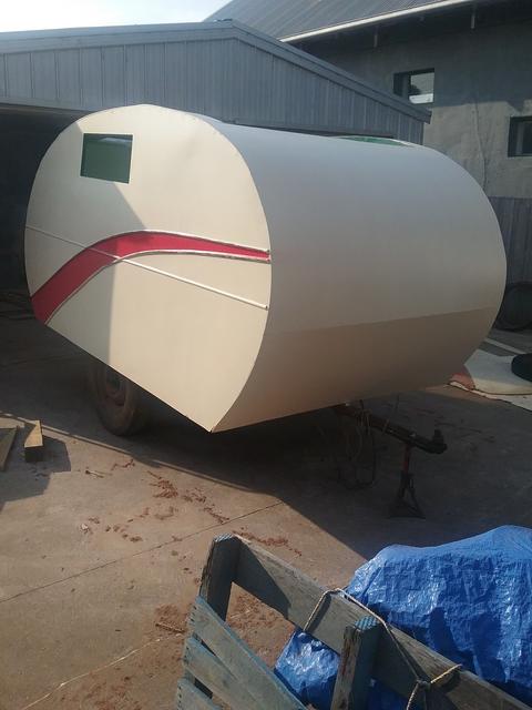

  Finally got the last sheets of masonite on front and first coat of colour On van to show up where to fix some of the masonite was around for 4 years and has a few marks on them coming along well still to put trims on left to match right side and front and back joints. Next job is to remove brace bar under draw bar as it is hollow and full of dirt and make it easier to clean and paint cheers chris

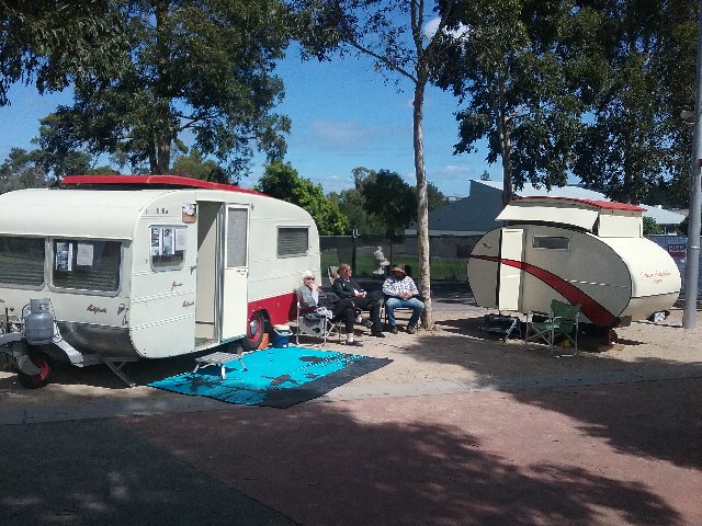

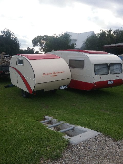

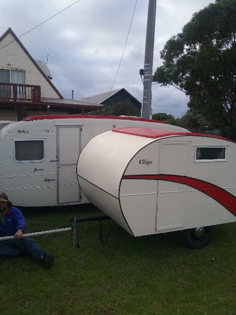

  /url]   Chips got his number plates on finally Getting chips and Bella ready for there weekend together Chips with Bella at the Melbourne caravan show

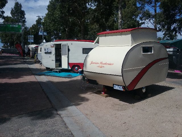

Thanks cobber and Ray I still have a few small jobs to do. I am really happy with the feedback from the caravan show and the amazement that such and old pop top van still exists. And a very special thanks to cobber for letting me be the next custodian of such a special van will be bringing it to the nationals hope you can make it to let you see the difference from when I picked it up cheers chris
