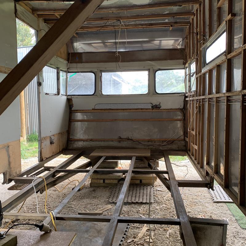

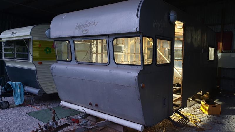

While we work frantically on our Hilandale to get her ready for Rosebud Rockfest, the Wayfarer has received some attention thanks to a friend and is now almost completely gutted. My question is should we be bracing the sides /roof of the van before we proceed any further? I'd hate for the remaining cladding to buckle or collapse.
This is the biggest roof hatch I've ever seen 1.1m x 1.4m. Might be a good spot for a couple of lightweight solar panels...? Reconstruction of the van should proceed in earnest over the summer
Post by Franklin1 on Nov 2, 2017 22:27:01 GMT 10
Hi Lazy Glamper, The "worst case scenario" during demolition is shown in the series of photos in a thread on the Classic Caravans forum. See this post: ditzygypsy.proboards.com/post/39826/threadDo whatever is necessary to avoid that sort of thing happening. cheers, Al.
Post by Gidget on Nov 3, 2017 5:44:43 GMT 10
I know!!!! What a disaster! That would never have occurred to me but after seeing the photos I'm treading carefully.

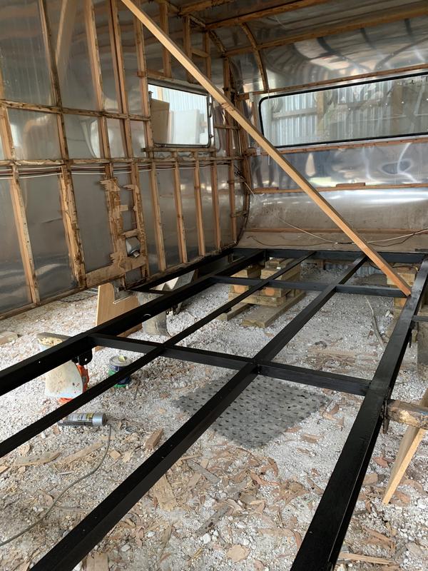

Post by Gidget on Nov 11, 2019 7:40:00 GMT 10
Well, after a few false starts and getting side-tracked with the restoration of my 1977 York, we are now back in full swing with the ground up restoration of our Wayfarer. Starting with the chassis which is getting a thorough rust proofing, new drawbar and new axles, wheels & electric brakes. It certainly feels good to get going again on this one. Won't be ready for the Nationals but hopefully Sunny will make his debut at the next Gippsland Gathering... url=https://postimages.org/] [/url]
