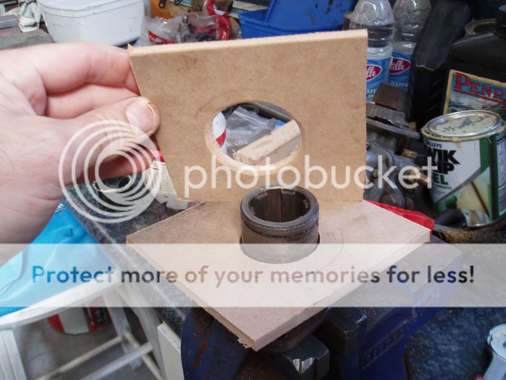

I then set about trying to find a new seal, but with no luck. The diff man says he can machine out the housing and maybe fit a modern seal, but he couldn't guarantee me that it would work properly as the neoprene would probably wear the shaft much faster that the leather.
So there is only one option when you can't find the bit you need - you make it!
Here is the original seal
And the input shaft
So I made a jig to hep me press a new seal.
Used some very heavy leather, soaked in linseed oil for a day or so, and just stretched it over the shaft. (It did take a couple of goes to get the cuts right)
I clamped it in to place for a day.
Hey presto - new seal. The diff man said it was great and he put it straight in.
