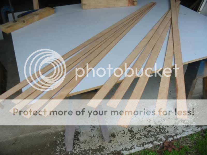

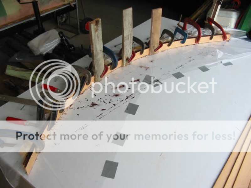

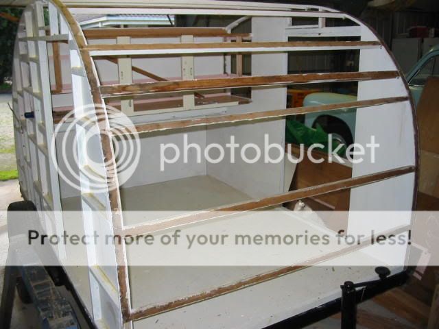

Post by humpyboy on May 30, 2010 16:57:31 GMT 10
Another weekend over and another update, two rear bows completed almost, Slats cut from a piece of knot free Oregon and ready. Number 1 clamped up, Number 1 out with number 2 clamped up, I have a full week ahead of me now so I don't plan to have anything more done soon so next update will be a while off, I intend to keep the setup I have for these bows so that I can make new bows for the new hatch, that way they will all have the same profile or at least I hope they will

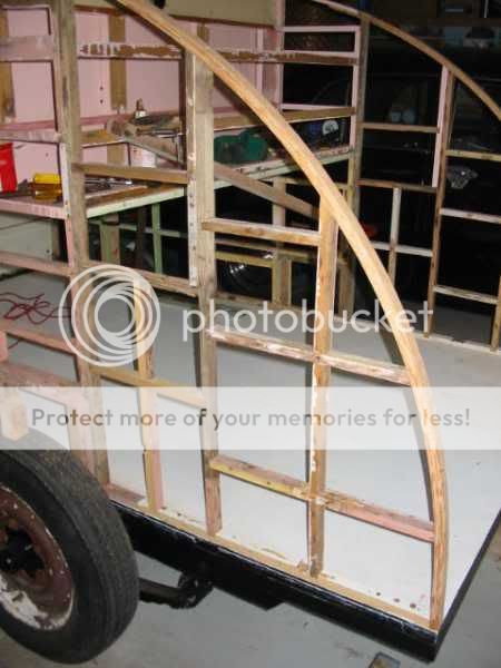

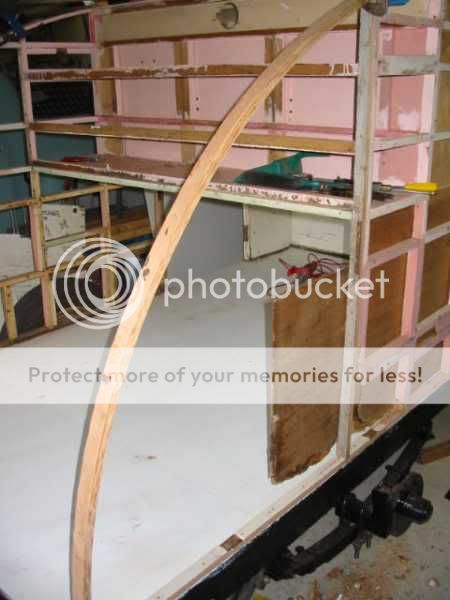

Post by humpyboy on Jun 6, 2010 19:42:40 GMT 10
Well here I am with an update, didn't think I'd have anything but had a good run this week end with some headway made, first up the bows after cutting to width. In the next two pics you can see how much of the old frame I removed and will be replacing due to rot and damaged wood. And also I removed the entire Kitchen. I was going to leave it and work around it but the more I looked and the more I removed it became quite clear that at some stage a repair or two had been undertaken so the decision was made to rip it out and start with a blank canvas. I then moved on to fitting the Air Conditioner ;D ;D ;D. As you can see no cladding inside or out, makes for a chilly night Brrrrrrrrr. I was lucky enough to score an extra day off with the upcoming long weekend so I now have four days to make some progress, am hoping to have all frame work put back with the other bits repaired where needed and my other access door in place, wish me luck.

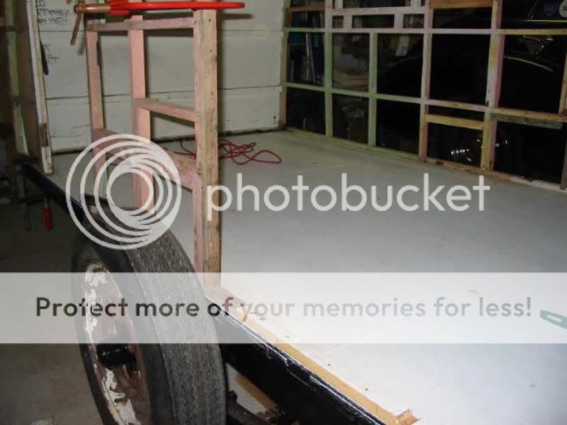

Post by humpyboy on Jun 11, 2010 22:09:09 GMT 10
Day one of my Looooong weekend and I've got all the framework replaced at the rear along with mounting tabs welded to my new guards, at the rate I went today I'm looking forward to making some real headway over the next three days, will keep working and upload more pics later.

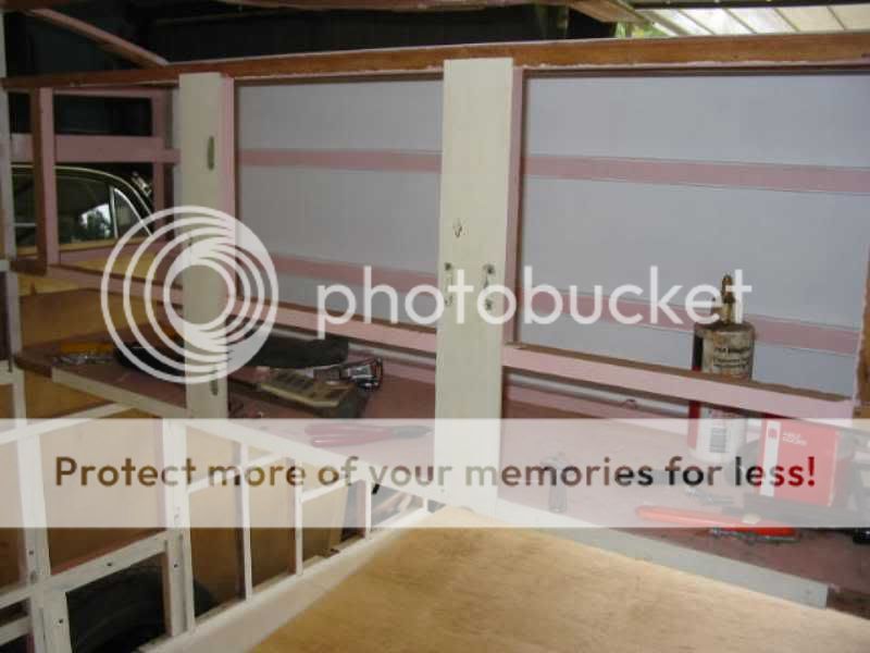

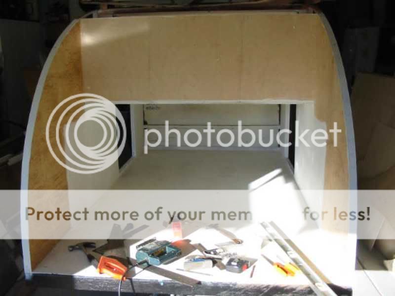

Post by humpyboy on Jun 14, 2010 20:25:41 GMT 10
Firstly thank you to those that have replied to my questions, all food for thought, I will look around for styrene pieces that I can use and I need to have a good think about if I really need 240 or not, now for long awaited pictures. Day one. Repaired frame work. Day two. Fitted my mounting points for the guards and some more De- construction. Day three. Internal cladding. Day four. Spent most of the day working on my Ute so not a lot of time left for the teardrop but I did manage to make a start on the frame work for the kitchen.

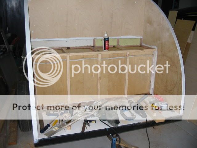

Post by humpyboy on Jun 20, 2010 21:17:58 GMT 10
Damn, had a post written and the speaker fell onto the keyboard and you guessed it, so now I have to start again. Only had today because I spent Saturday over at my mates shed working on the engine for my Ute, so today I finished off the section of wall between Kitchen and Sleeping area filling the frame work with insulation and paneling it over as well as inserting a piece of flex for power. I also did some more DE-construction so I can finish off the internal lining.
