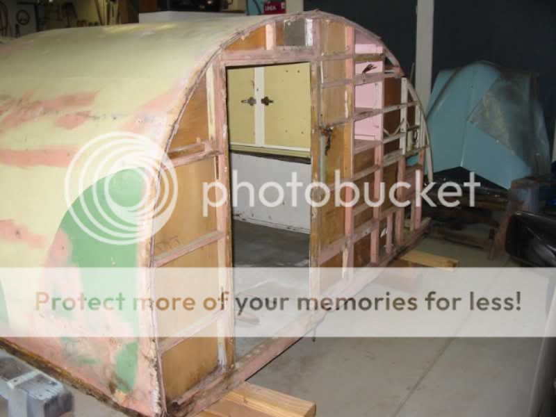

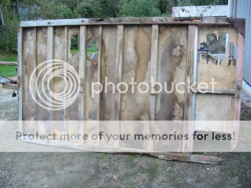

Post by humpyboy on Apr 4, 2010 21:32:06 GMT 10
Well it's happening, today a mate came over and together we man handle the tear on to her side, I then proceeded to remove,axle springs and drawbar, It was then I found the first of the rotten timber that I didn't know about, the first two pics are the front mounting point for the left side spring hanger and then the rear mounting point, the third pic is the mounting area for the right side spring,never having restored a van of any sort I'm open to suggestions, I'm thinking along the lines of replacing both timbers the full length Now it gets a little wierd, I couldn't work out why the wheels sat differently in the gaurds, that was untill I had it on it's side, check out the following pics. Rear hanger Left side Rear hanger Rigt side Front hanger Left side Front hanger Right side You will notice by looking at the cross members that niether Spring is mounted at the same point, so I looked a little closer and found this, Left spring Right spring WHAT THE!!!! you can see the centre bolt in the first pic but in the second pic they have cut off the head of the bolt and with a piece of plate and a bit of round section they have moved the mounting point for the axle. I also noticed that the bearers that the springs were mounted to had a difference in thickness of 30mm plus the springs only had a difference in hight of 20mm, me thinks maybe a new set of springs also So to all you long time restorers out there, you can now come forth with all your wisdom ;D
Post by DC3Td on Apr 4, 2010 22:32:49 GMT 10
Hi Humpy. Well you certainly grabbed the bull by the horns so to speak & flipped it on her side. Amazing what one finds when they aren`t looking! So,where to begin? Well i guess you`re going to replace the steel work - springs,shackles,hangers,axle etc ? So onto the woodwork. Nothing bolted/screwed internally to the floor other than the floor to the cross members? Not being there to see it in full then, i`m of the mind as you`ve got clear access, to remove all cross members & perimeter frame. I`d have a couple or so sticks of wood at the ready to place temporary from wall to wall bottoms if you remove the under frame to stop sagging! Measure diagonals before & after. New timber perimeter frame/cross members cut & joined as one. Slide into position from top, then slip the bottom of frame in. Check diagonals & if happy with squareness,screw/bolt into place.Then its the refitting of the steel ware. When i replaced the timber chassis/tow rails on my Td, i had an old water trough about 14 or 15 feet in length,half filled it with old engine oil & soaked them in it for a few weeks or more. Protects the timber but also gives it an aged look! Anyways,my two bobs worth of ideas. Hope it all goes well. cheers gordon

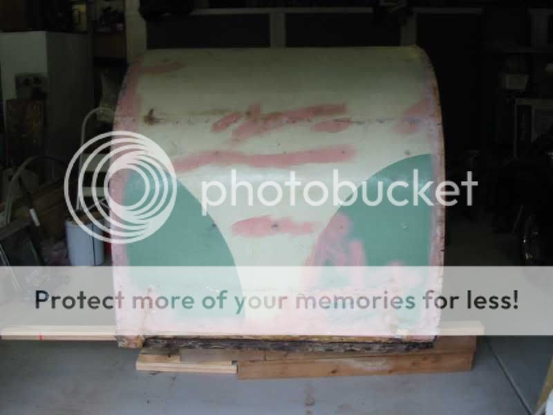

Post by humpyboy on Apr 9, 2010 19:30:23 GMT 10
Well here we are, Friday night and straight to the shed when I got home, began by removing a couple of dozen screws that were holding the ally sheets in place at the front and then peeled it back some to discover that she was originally Bondwood with canvas over the top, so at least now I know the ally sheets were added later oh yeah and found more rot DC3Td, in answer to your question as to how it is attached, this I am not 100% sure but it looks as though they have made the chassis then fitted the floor then bolted through the lot then fitted the wall frame over the top of the bolts, I think I'm going to have to cut the bolts off with the grinder to be able to dismantle the under frame then replace them after I roll it back over on it's wheels. Will get out there tomorrow and dismantle some more and see where I go from there.

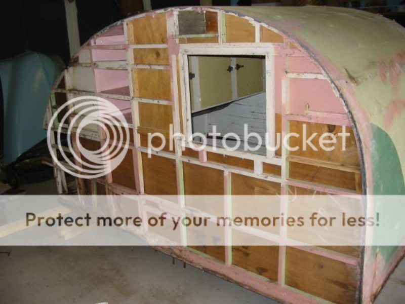

Post by humpyboy on Apr 10, 2010 15:17:03 GMT 10
3.00 pm and just me had me some lunch after a 10.00 am start, Just a quick update I have really got stuck into the van today, have got it back up the right way and have removed all the ally sheets and have found that the upper frame work is just nailed to the base so the plan now is to lift the frame away far enough to get a hacksaw blade in to cut all the nails through and then lift and separate, remove the base completely and start from there, after repairs and such to the base it will be placed back under the frame and reattached, more photos to follow showing today's progress. Okay then photo time, have done as planed with everything going smoothly as you can see from the pics. Back the right way up. Naked sides. We have lift off. OH where he go? OH there he is. So the plan of attack now is to rebuild the base from scratch reattach springs and axle along with the draw bar after refurbishment and then roll it back under the frame, then all the repairs to the frame will be undertaken and returned to it's rightfull resting place, after this is done I'll remove the old ply skin over the top and reclad it all inside and out.

Post by DC3Td on Apr 10, 2010 23:59:49 GMT 10
Hi Humpy. Didn`t think you were allowed to put naked pics here! Doing real well so far especially as the floor & frame removed together. At least now you have a blank canvas to work off & can see all the wood rot that needs replacing. cheers gordon

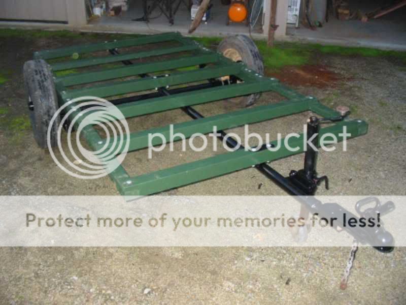

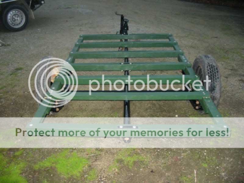

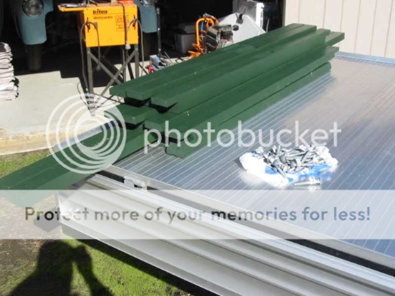

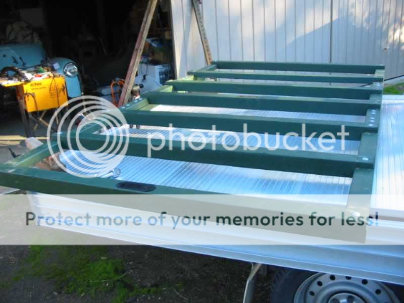

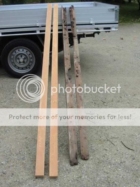

Post by humpyboy on May 8, 2010 19:25:31 GMT 10
Well here we are with another update, first some pictures from last week when I got my new sticks organized. New and old, can you pick which is which? The bits wot go across. And today when the bits come together, what do you all think of my new mobile workbench? Taking shape. And at days end as the sun sets. And going back into storage, where else did you think I'd put it ;D ;D Still a bit to do but I've broken it's back so to speak and can do those little bits in the evening after work while I look into new flooring.

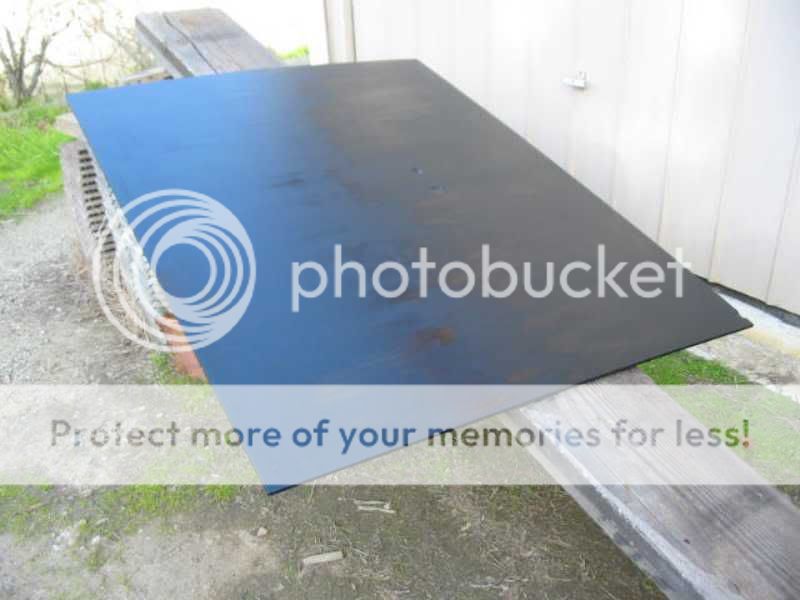

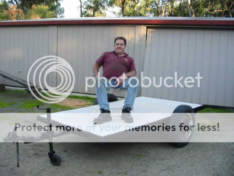

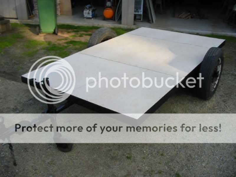

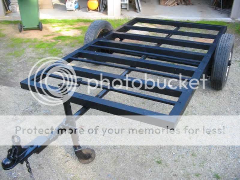

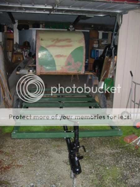

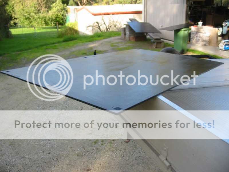

Post by humpyboy on May 22, 2010 21:03:58 GMT 10
Well here we are again with yet another update, not a great deal of change but will be ready very soon to drop the frame back on, spent most of the day painting the chassis and underneath of the floor with a waterproofing paint. My waterproofing paint of choice. This stuff dries but remains soft and flexible so should move with the timber nicely. Floor sheets down. Next stage is to paint the floor and then lower the frame back on in readiness for repairs to it. Now a bit of fun for those watching this thread. "WHO AM I ?" I live in NSW. I build old caravans. I like old cars. And I have a shed were I invent things. Scroll down for answer. Keep going Nearly there Sorry reddo but I had to do it,
