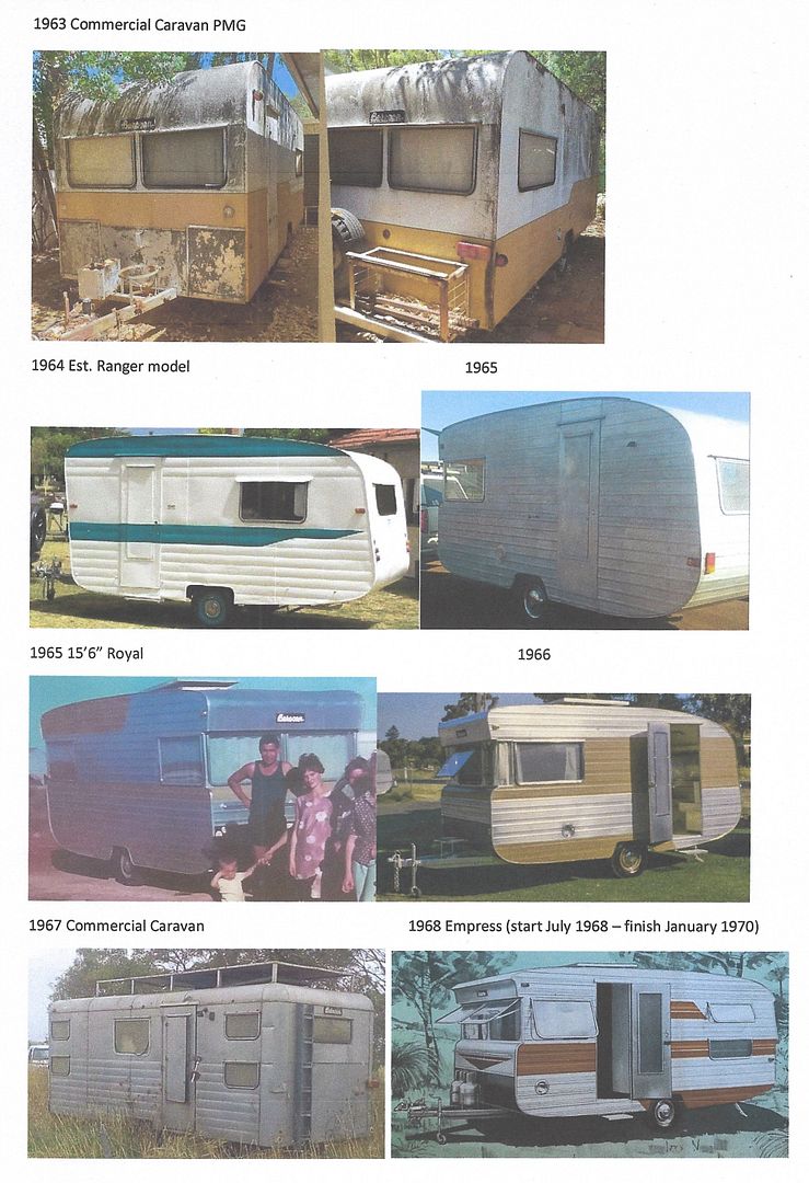

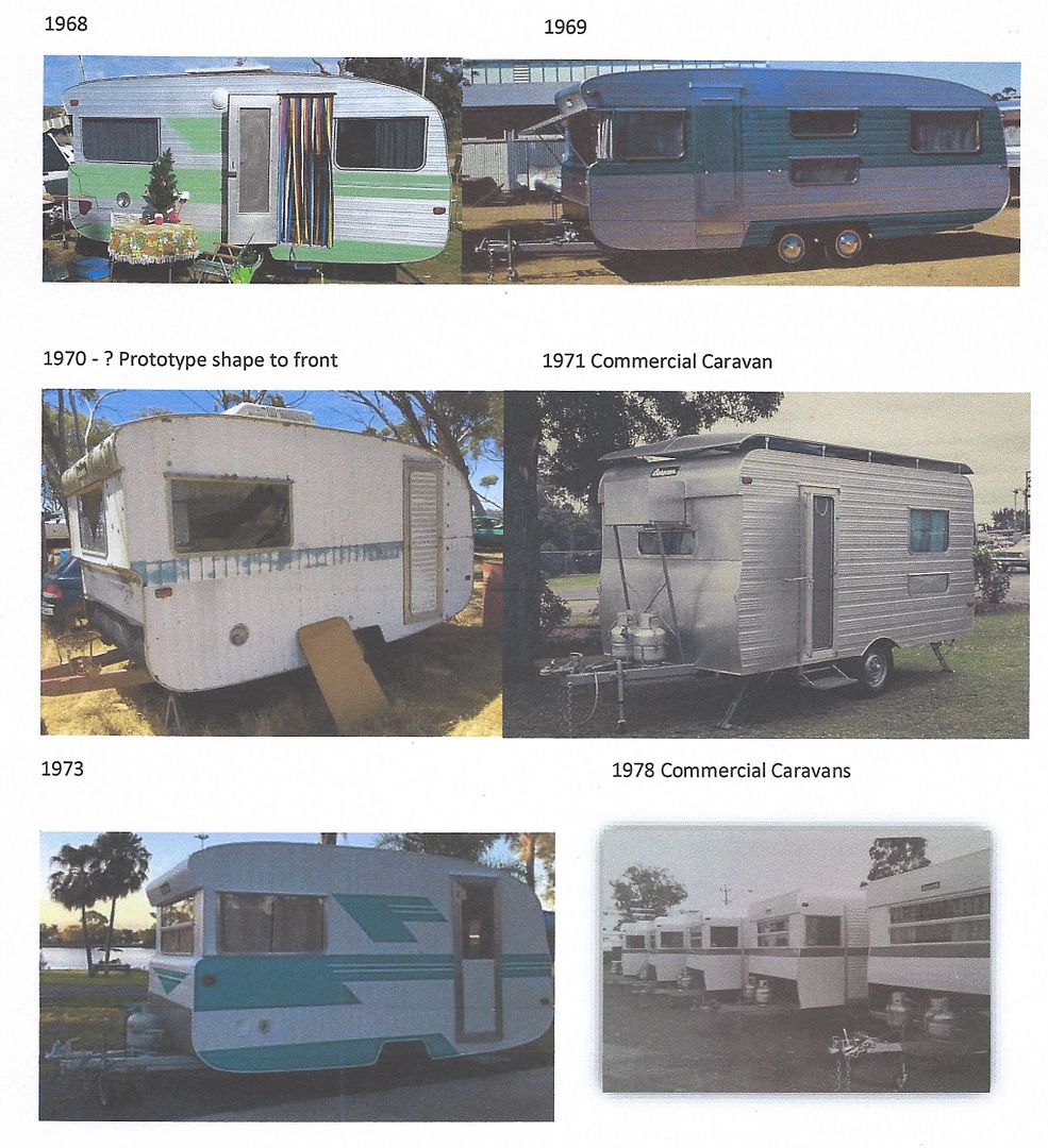

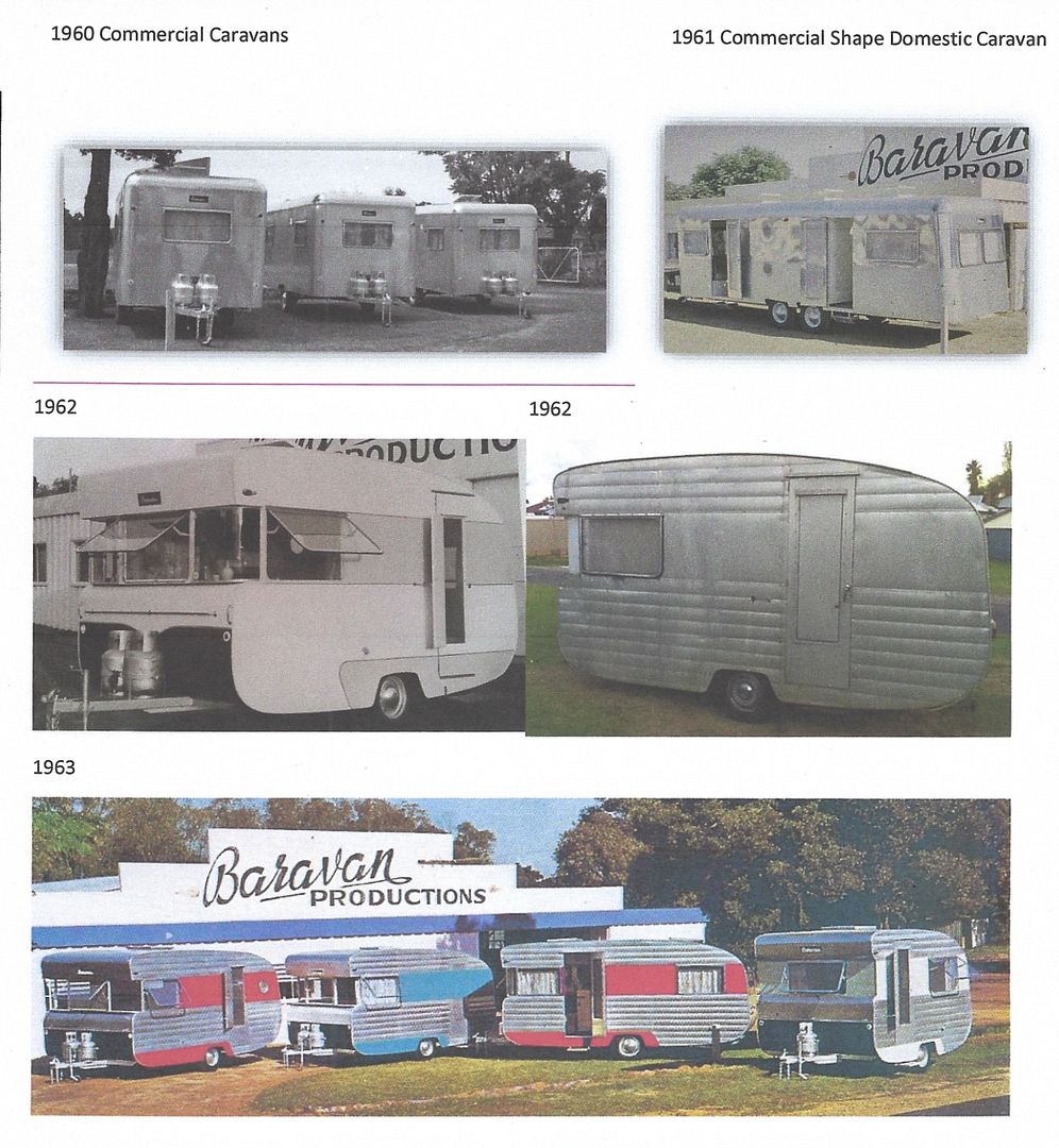

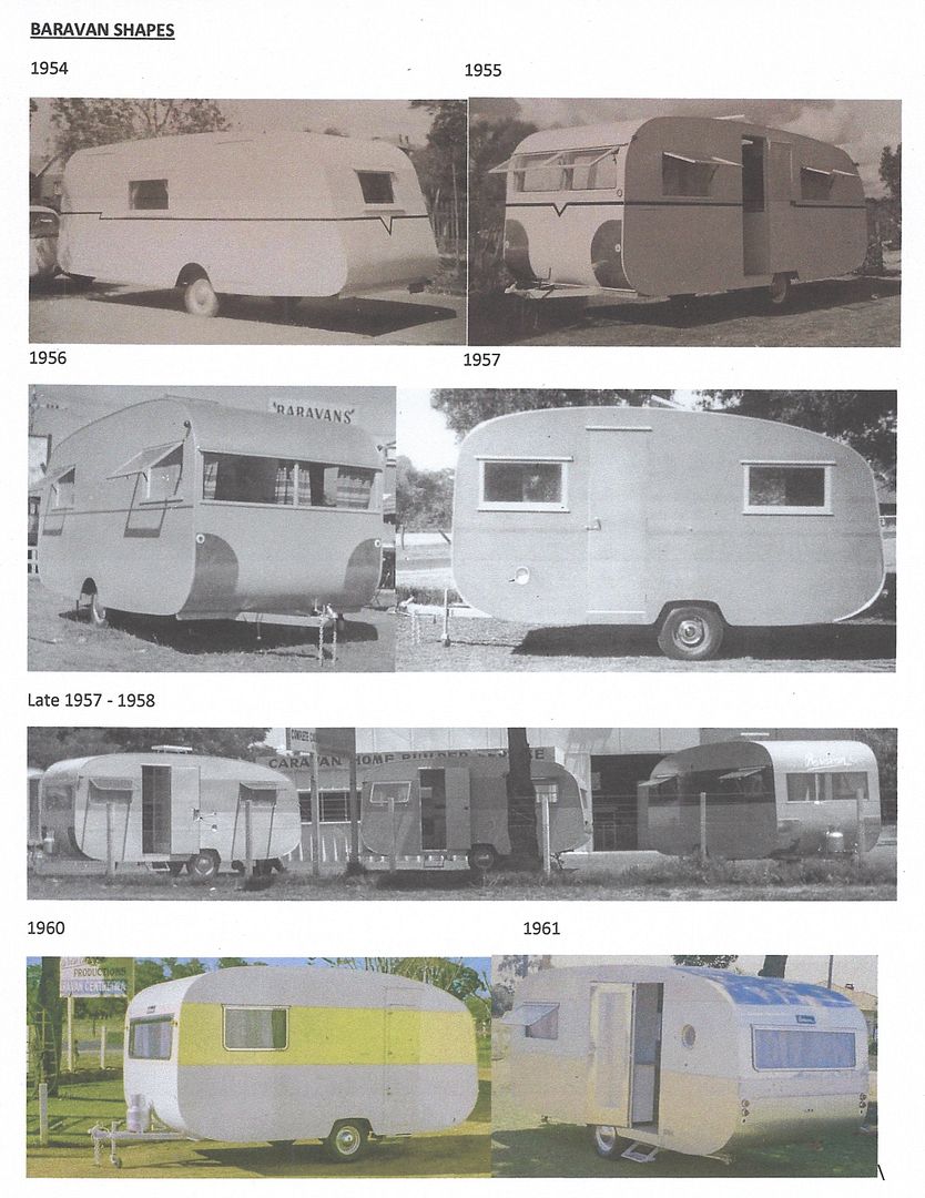

In September 2020, Bruce Barrett provided us with a detailed history of the Baravan caravans built by his father, David Barrett. The history can be found in the first post on this thread here, and a guide to the body styles used by Baravan from 1954 through to 1978 can be found here. When Bruce provided us with the history, he told us that he was in the process of building a new caravan which would be the 'last Baravan'.
