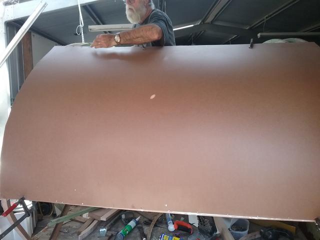

G'day Chris, Mate to know more than you need to know about Masonite click on this link archive.org/stream/WhatYouOughtToKnowAboutMasonitePresdwoods/CCA87486_djvu.txtand go down to answer 110 to 118 that deals with bending Masonite, that is when the wetting process comes into play, with the radiuses you'll be dealing with I don't reckon you'll need wetting so for my money I'd probably glue it with 'no more nails' Cobber.

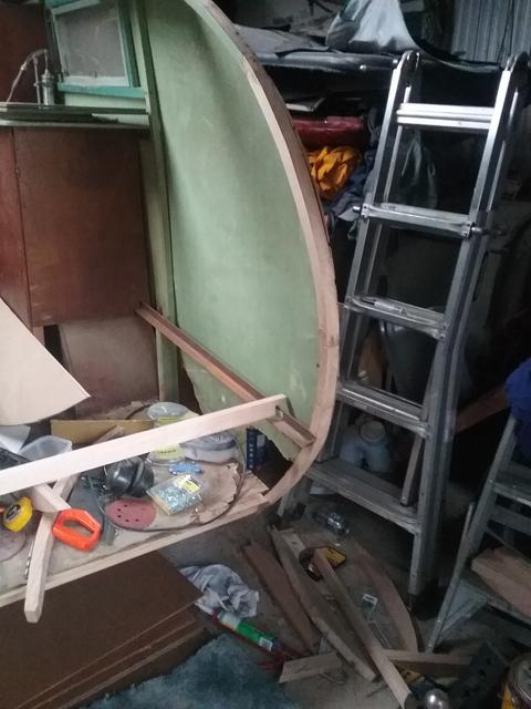

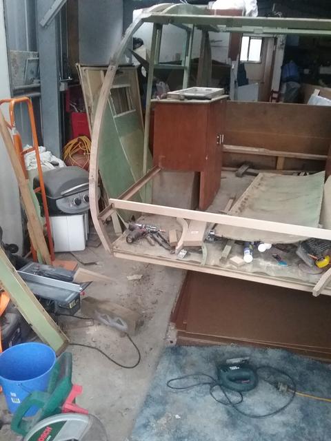

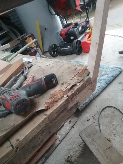

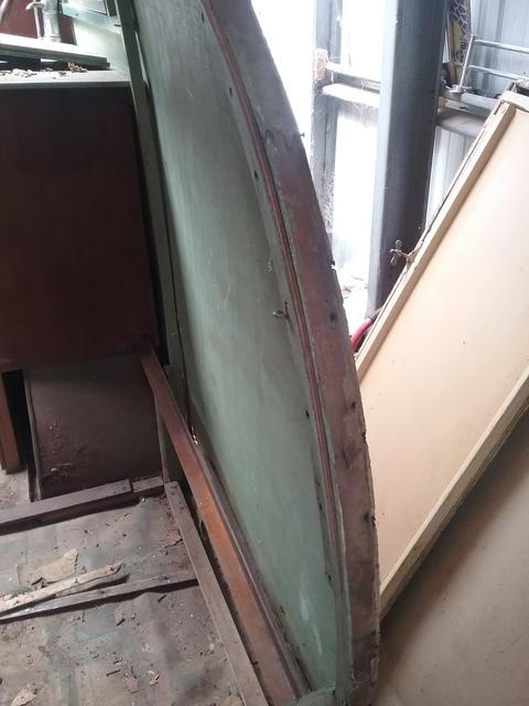

One of the parts to be replaced Some of the parts that have been replaced The back end getting ready for repairs There seams to be 3 sections cracked and minor repairs made to hold together Some of the progress so far have finally sourced masonite it is getting harder to get in 3.6 mt sheets hope to do one side of the back this week there is a bit more work in the back cheers chris

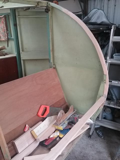

Post by aussieute on Oct 4, 2019 18:11:54 GMT 10

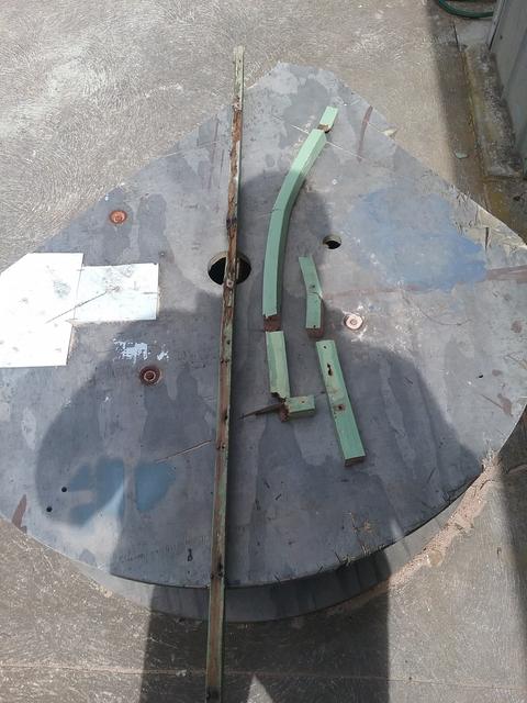

The parts that were cracked on left and right back replaced Had to rebuild the back left corner as it was missing the side cladding now coming of now the corners are fixed The curtains are bit the worst for wear have found someone that will reproduce the original curtains hope they come out good. Will hope to post more photos at the end of the weekend cheers chris

G'day Chris, an excellent professional job on the van so far.๐
Can we please have some more information on what timber you used to replace the rear curves and how did you bend them to shape?
Cheers, Al.
Post by aussieute on Oct 5, 2019 19:15:55 GMT 10

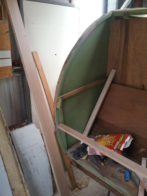

Hi Franklin1 I have used Tasmanian hardwood bought 110 x 30 and cut using jig saw making it a few mm bigger to allow for sanding to get rid of jig saw marks. Using old frames to get the right shape for templates and cut the wood to get the most out of the timber with as few joints as possible. There were a few joints in the original timber but very hard to pick up cheers chris

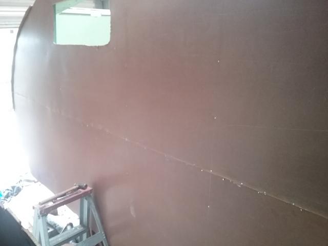

Post by aussieute on Oct 8, 2019 16:17:12 GMT 10

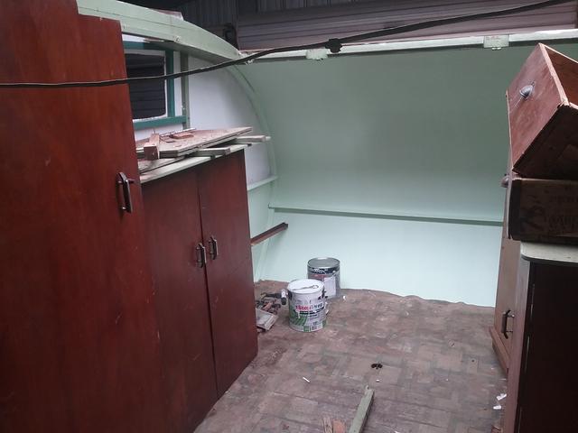

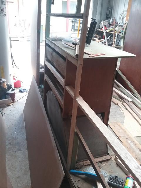

[/url] Had to replace the cracked upright frame and put frames in for masonite join Had a couple of days off work so got a bit done starting to look good All the cupboards have paint on them lots of time to clean them while waiting for the rain to stop so I can cut the masonite out side cheers chris

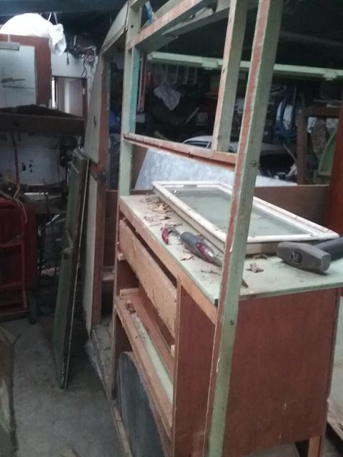

Post by aussieute on Oct 13, 2019 18:27:21 GMT 10

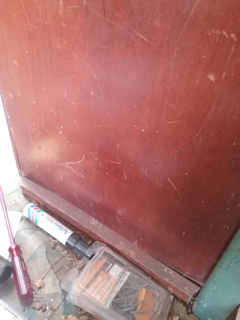

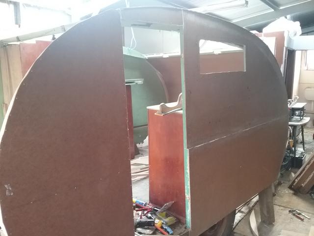

upload image free wapTook the side masonite off and found some more broken timbers roof beam in 3 areas and upright cracked upload image to urlupload a pictureThe cupboard side had delamanating ply and boarers in it so had to be replaced getting I'm getting there So far it's better than I expected cheers chris

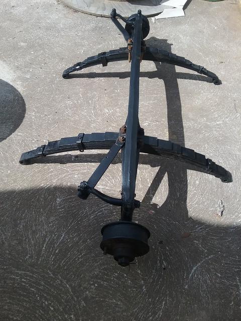

Finally got home for 3 days to work on van.Took out springs to get reset very soft
Post by aussieute on Nov 7, 2019 18:36:03 GMT 10
Put the springs in to pedders at 10 am got a call at 3 pm they were ready reset leaf added and broken Spring replaced thats what I call quick has made a big difference it was dropping 60mm when getting in. Bought new shackles but they were too long new tyres arrive tomorrow cheers chris

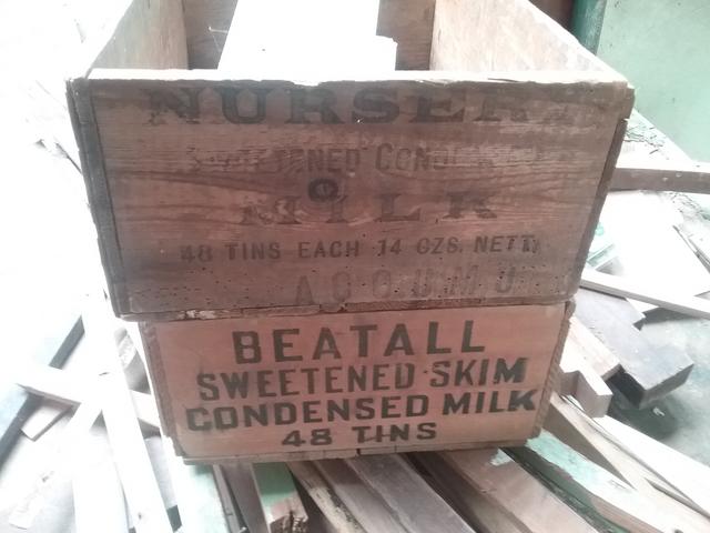

Some of the work so far started painting inside the front and roof left to clad These old boxes were in the cupboards cannot find anything about them Now 5 weeks till I get back to do more cheers chris
Post by cobber on Nov 9, 2019 18:08:00 GMT 10
Good on ya Chris, so much to do on such a little van eh ? I tried to research and find some information regarding those boxes to no avail but, somebody might know something about them ?
Post by DC3Td on Nov 9, 2019 22:06:54 GMT 10
My two cents worth regarding the boxes - BEATALL - Probably of NZ origins & produced by Nestle/Anglo Swiss Condensed Milk Co.Early 1930s. Main retailer - Star Stores Wellington NZ. NURSER - (Possibly 1800s) Gail Borden Brand & sold through Parr & Bergin Pueblo Colorado USA.

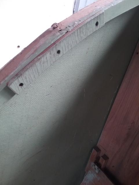

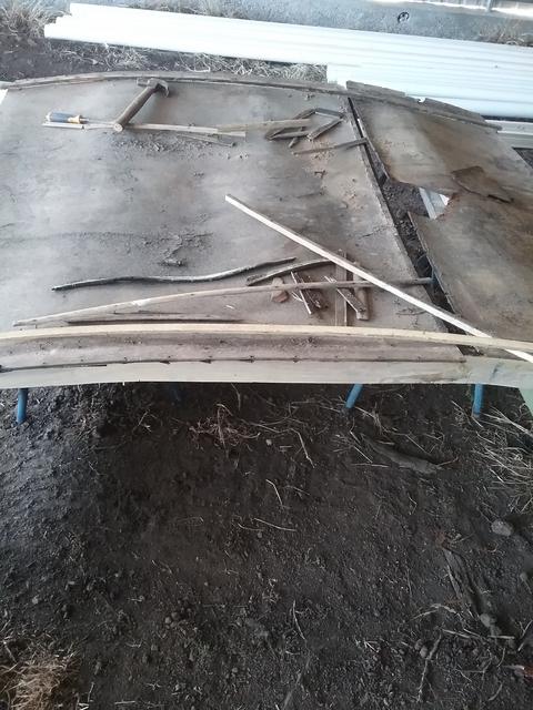

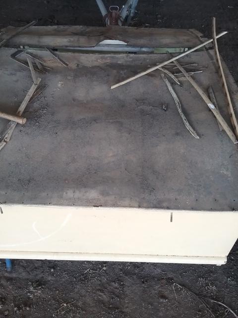

I have brought the roof with me on live away to work on after work the roof suport frames are in desperate Need Of replacing as they are badly bent at least the main frames are good Have just finished putting up my new caravan storage shed for my Jennisons Now to get them here before its full cheers chris
