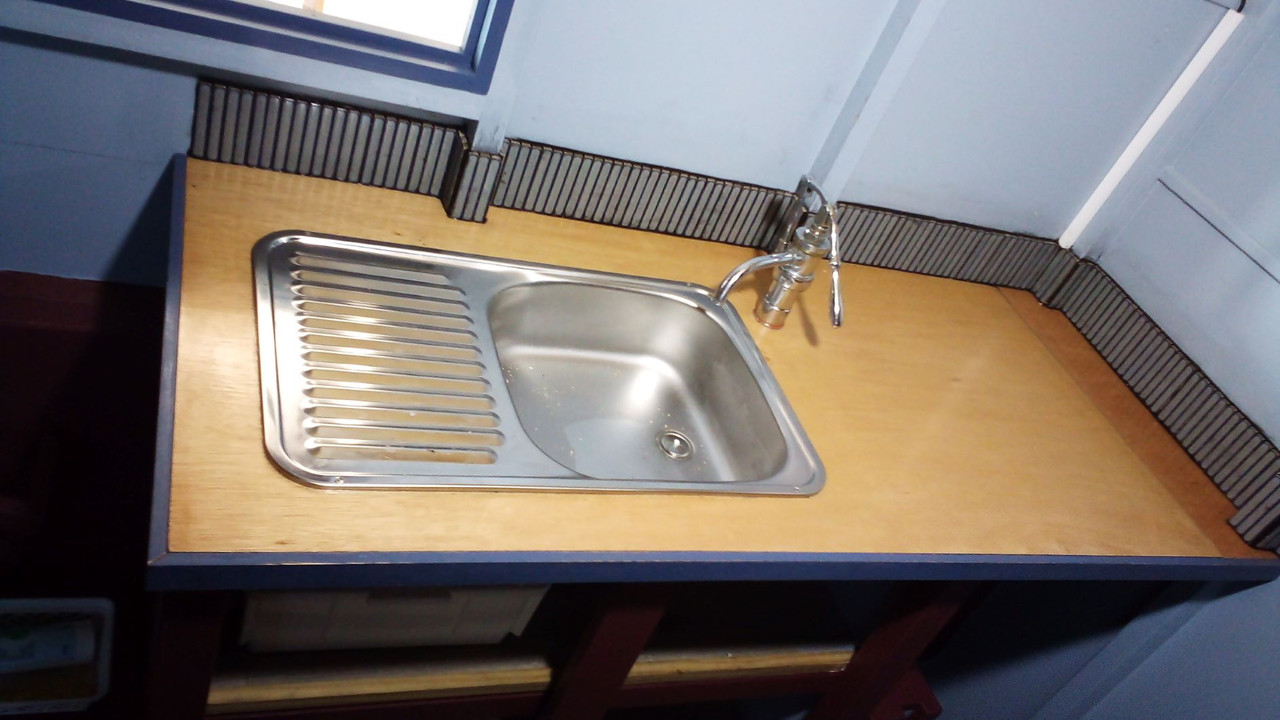

As it seems to be a rather slow week on the site, i thought I'd give an update on progress. I am happy to say that the electrical work is finished. Internal LED lights and clearance lights are fitted. As well, I added both internal and external 12 volt outlets for fridge and side awning light, as well as a double USB outlet. Deep cycle battery is fitted to 240 volt charger as well as to vehicle via an Anderson plug, so that it charges when travelling. Have also fitted internal and external 240 volt outlets. Lights Have also made progress with the fitout. Benchtops are in and splashback tiling done. Unfortunately there had to be a join on the sink benchtop which has slightly mismatched colour. I might build a shelf over it for coffee/tea items. Yes, the plumbing is also finished, with water connected to tank and outlet all working! The door hardware has been fitted and they will be installed next week The "to-do" list is slowly getting shorter!!

Very unique way of tiling, I like it.

Hi mustang. Decided to lay the tiles vertically simply to avoid too much cutting! I used Parfix Adhesive/filler to attach them and grouted with silicone to allow for flexing.

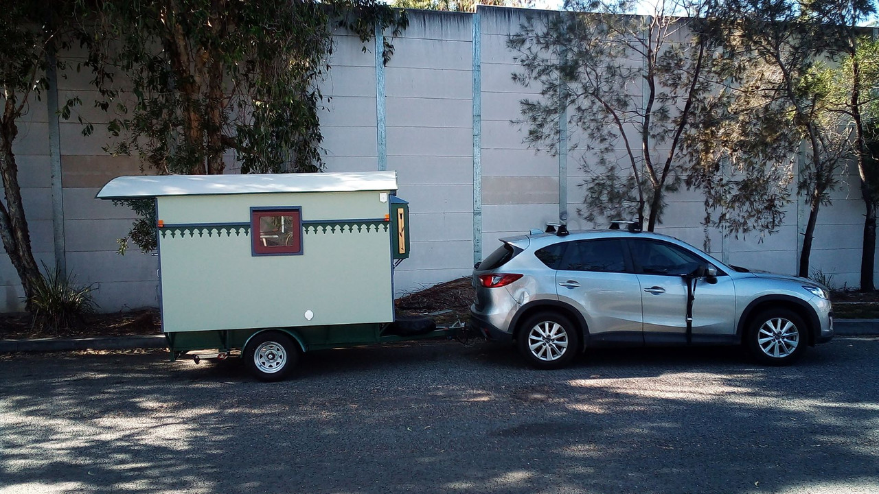

Finally doing what Cino Vardo was built for - travelling and enjoying! So, should one paint those white electricals covers to match the wall?
Post by shesgotthelook on Sept 19, 2019 7:55:51 GMT 10
Looks fabulous Ray. Shame I sold the harness pony years ago. Yes to painting the white covers, maybe bakelite brown!
