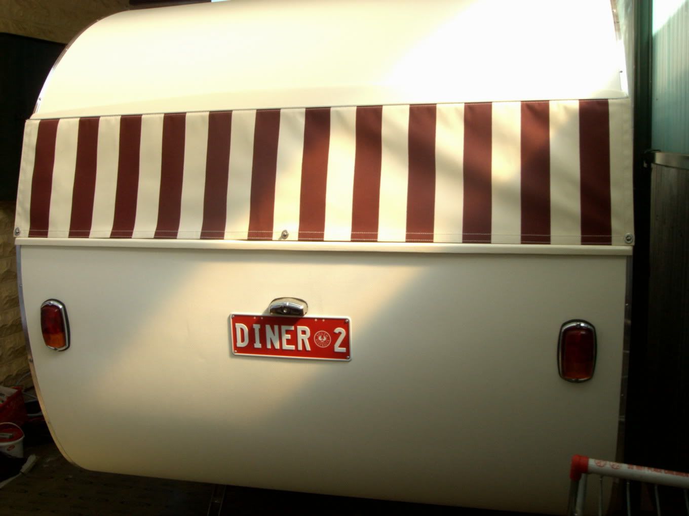

I had these canvas blinds made to make it darker inside. It will also keep it cooler in summer and stop the fabric inside from fadeing. It will also keep the water of the windows if it does rain. The pictuer is not the best but the strips match my car. It was taken under the caravanport where Diner2 sleeps awaiting her next big adventure.

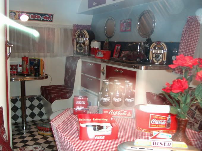

A couple more picture taken by another caravan buff Inside shot of Diner2

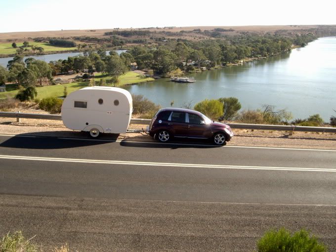

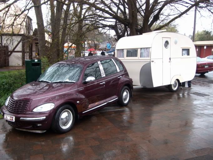

Took retro1 ( the PT ) and diner2 ( the van ) along the River Murray in SA on the weekend and took this great shot.

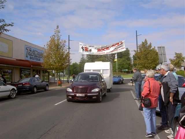

This is the PT and van in the parade at Waikerie SA on Saturday for the rock'n'roll festival

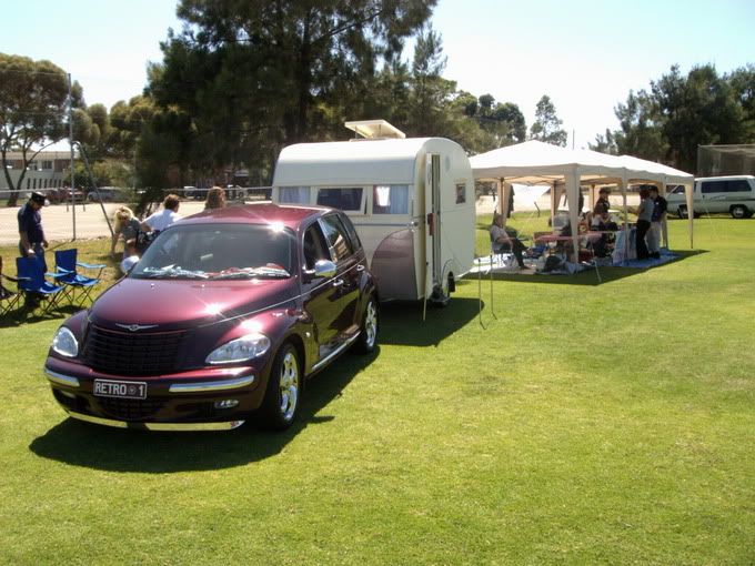

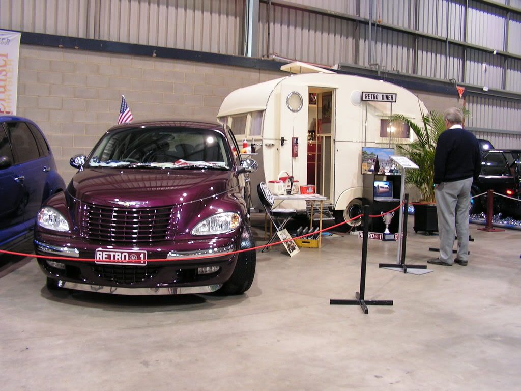

Here are two pictures taken at a recent Australian Motoring Expo (AME) show in Adelaide. We went with the PT Cruiser car club of SA. Loads of interest in the van and lots of comments on how they knew of other vans in the families history and of the grand adventures they took these old girls. The rear curtains were removed so people could look in the back (2nd picture sorry about the flash refelection) and as the van is themed Coca-cola we went all out. I hope by doing displays that it may promote the vintage caravan movement in Australia.

Did a PT Cruiser show day in SA where 60+ PT's went and the car club asked me to take the van. I got a set of Moon disks at Wintersun so I put them on the orginal rims to give it that older look. The steel rim is painted the same as the van to give it that whitewall look. I also got a trophy for the car on the day. I'm going to Berri this weekend with some rock n' rollers who also have old vans. The way I see it the more that people see these old vans the better as it gets some of the old ones out of the sheds and padocks and back on the road.
