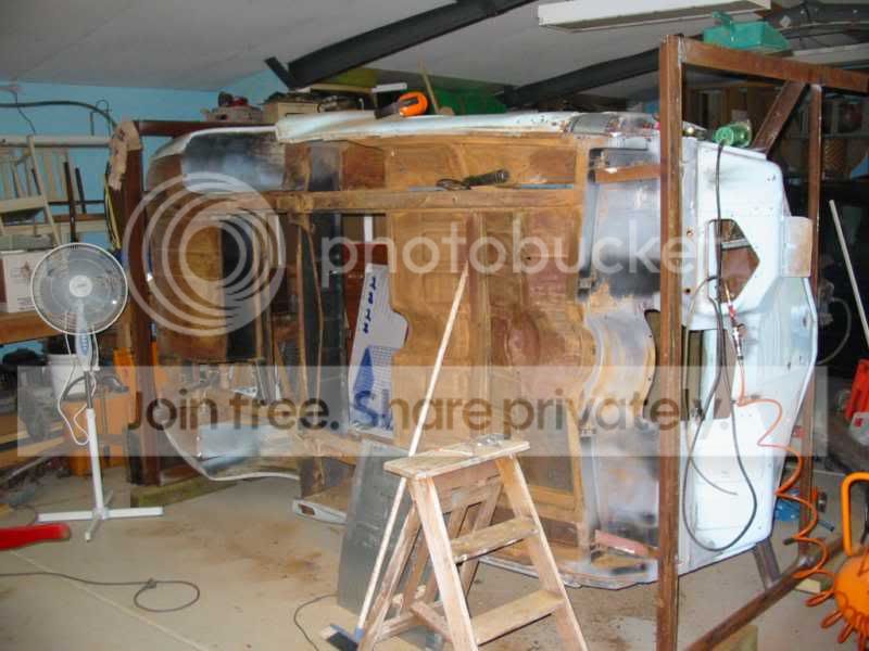

I thought that I had taken lots of photos but when I went searching I had trouble finding the ones that I “thought” I had tooken.

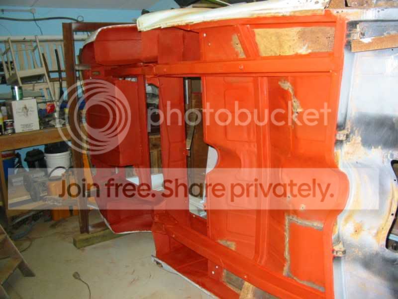

I laid her on the side to make life easier for me while working on the underneath.
![[image] [image]](http://i1012.photobucket.com/albums/af241/humpyboy/IMG_1701DesktopResolution.jpg)
![[image] [image]](http://i1012.photobucket.com/albums/af241/humpyboy/IMG_1702DesktopResolution.jpg)
![[image] [image]](http://i1012.photobucket.com/albums/af241/humpyboy/IMG_1719DesktopResolution.jpg)

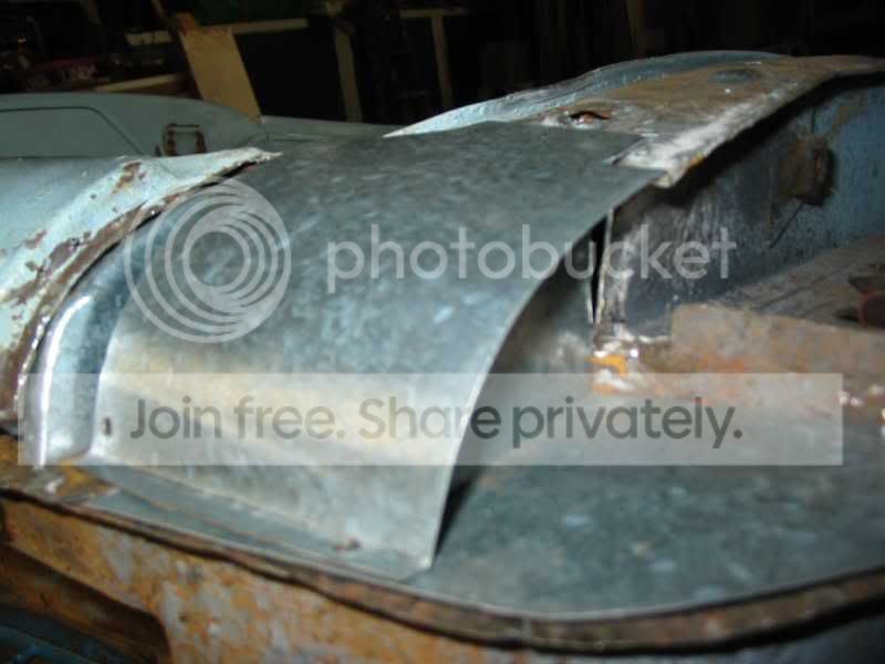

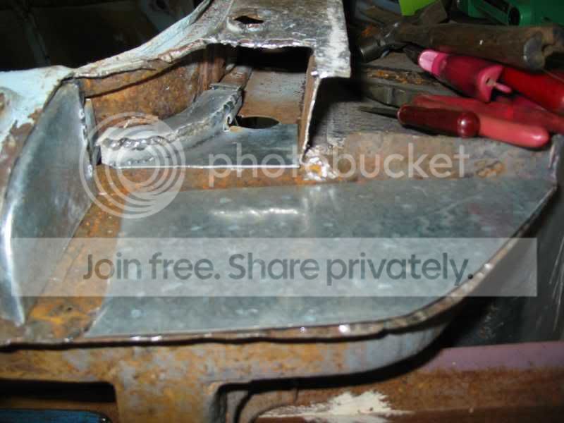

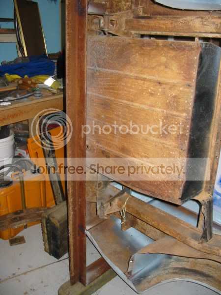

Here are a couple of close up shots from when I repaired the lower section of the “A” pillar.
![[image] [image]](http://i1012.photobucket.com/albums/af241/humpyboy/IMG_1705DesktopResolution.jpg)
![[image] [image]](http://i1012.photobucket.com/albums/af241/humpyboy/IMG_1706DesktopResolution.jpg)

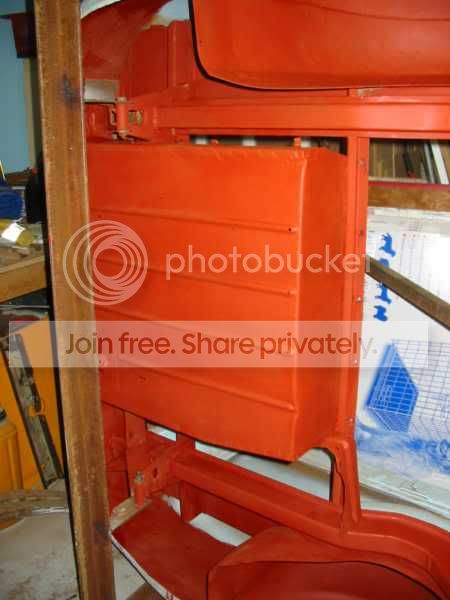

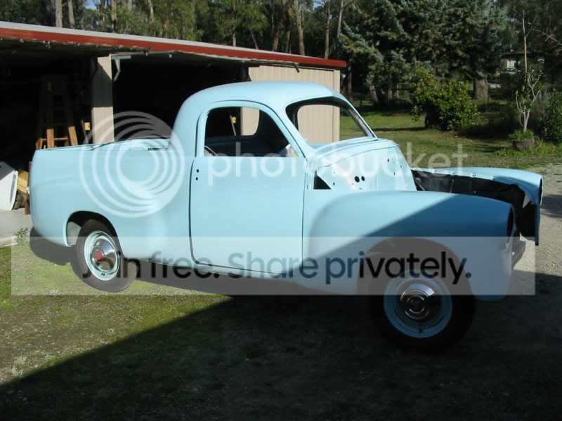

So after I had done my repairs I took to it with some paint.
![[image] [image]](http://i1012.photobucket.com/albums/af241/humpyboy/IMG_1727DesktopResolution.jpg)
![[image] [image]](http://i1012.photobucket.com/albums/af241/humpyboy/IMG_1729DesktopResolution.jpg)

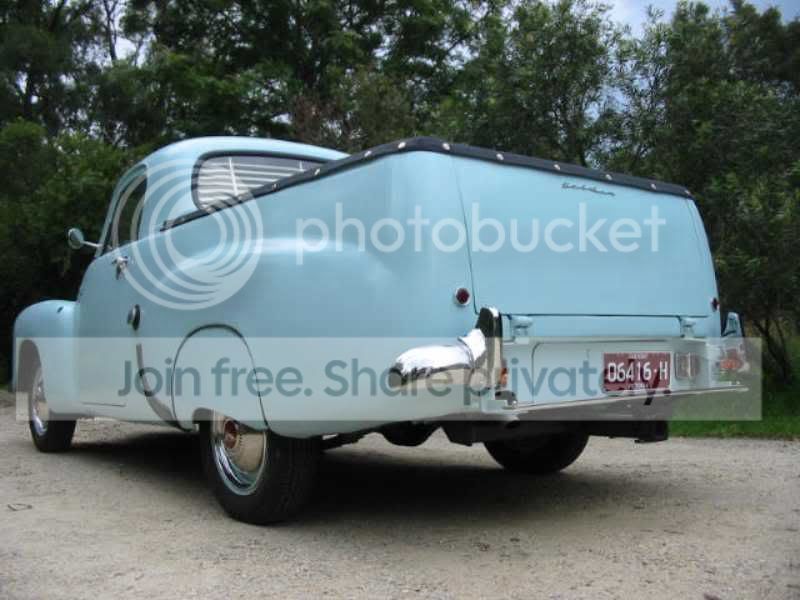

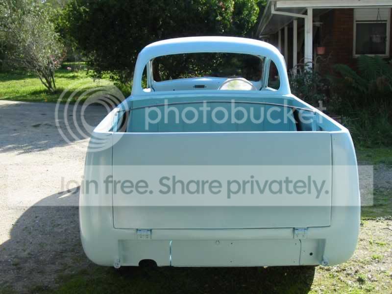

That’s when I finished up with something that looks like this.
![[image] [image]](http://i1012.photobucket.com/albums/af241/humpyboy/219-1977_IMGDesktopResolution.jpg)
![[image] [image]](http://i1012.photobucket.com/albums/af241/humpyboy/219-1976_IMGDesktopResolution.jpg)
![[image] [image]](http://i1012.photobucket.com/albums/af241/humpyboy/219-1978_IMGDesktopResolution.jpg)
![[image] [image]](http://i1012.photobucket.com/albums/af241/humpyboy/219-1979_IMGDesktopResolution.jpg)

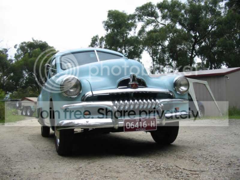

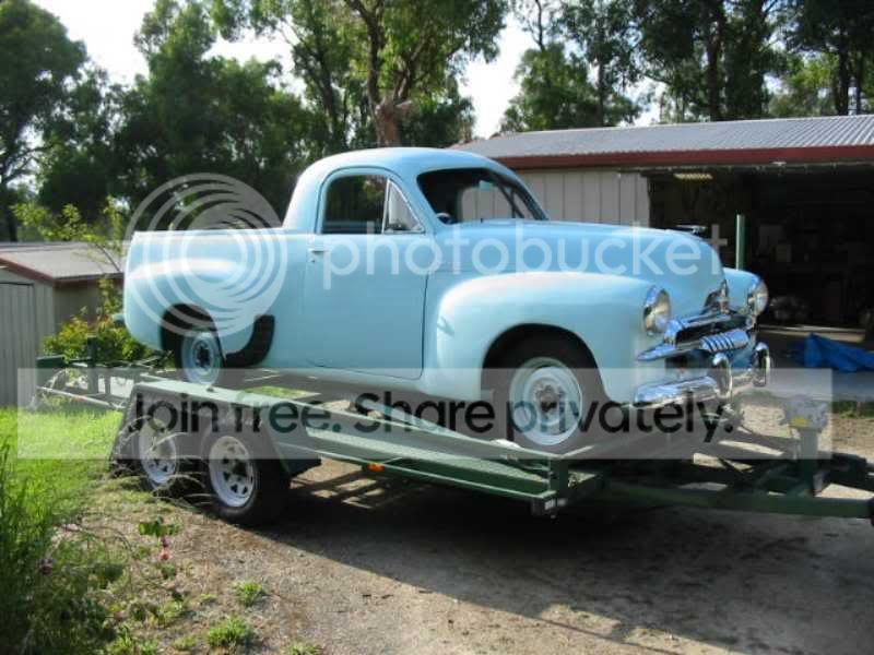

So then today I loaded her up.
![[image] [image]](http://i1012.photobucket.com/albums/af241/humpyboy/233-3312_IMGDesktopResolution.jpg)
![[image] [image]](http://i1012.photobucket.com/albums/af241/humpyboy/233-3309_IMGDesktopResolution.jpg)
![[image] [image]](http://i1012.photobucket.com/albums/af241/humpyboy/233-3311_IMGDesktopResolution.jpg)
![[image] [image]](http://i1012.photobucket.com/albums/af241/humpyboy/233-3310_IMGDesktopResolution.jpg)
And we went for a little drive to the Auto trimmer where she sits waiting to have her interior finished, if you look closely in the first pic of the last group you can see the seat sitting in the back of the Ute (tow Ute) that is which was recovered some time back along with the door trims so he needs only to do the hood lining, carpet and associated bits and pieces which he hopes to have done next week, then all that is left is to go over all the mechanicals and electricals and she is ready for some plates and the road, oh yeah nearly forgot, also in that first picture you can see the straps at the rear holding her down, these were placed around the tow bar, essential piece of equipment NO!!

Well here she is, all dressed up and waiting.
